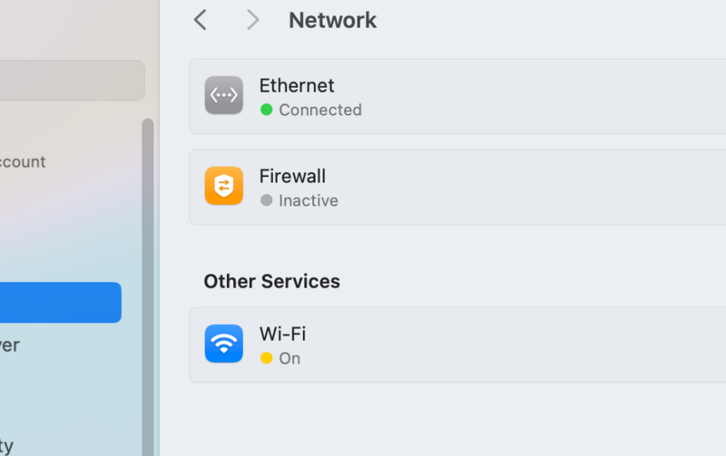

Can u send screen shot of wifi and system information>network>wifi

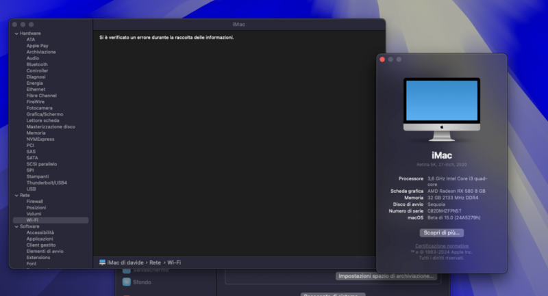

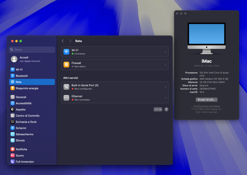

I have the same issue in Sequoia. If I update to 1.4.1 and either remove or leave -amfipass, I get a kernel panic. If I keep amfi=0x80, the system boots, but the Wi-Fi is only partially displayed and works only if I click on "Other". The problem always occurs when I apply the OCLP patch. If I remove it, the system works with amfipass.kext.
35 minuti fa, alighafourian ha scritto:
that was Sonoma we have problem with sequoia
This is what happens in Sequoia. I have set amfi=0x80, otherwise it won't start; I have applied OCLP 1.6.0 nightly.

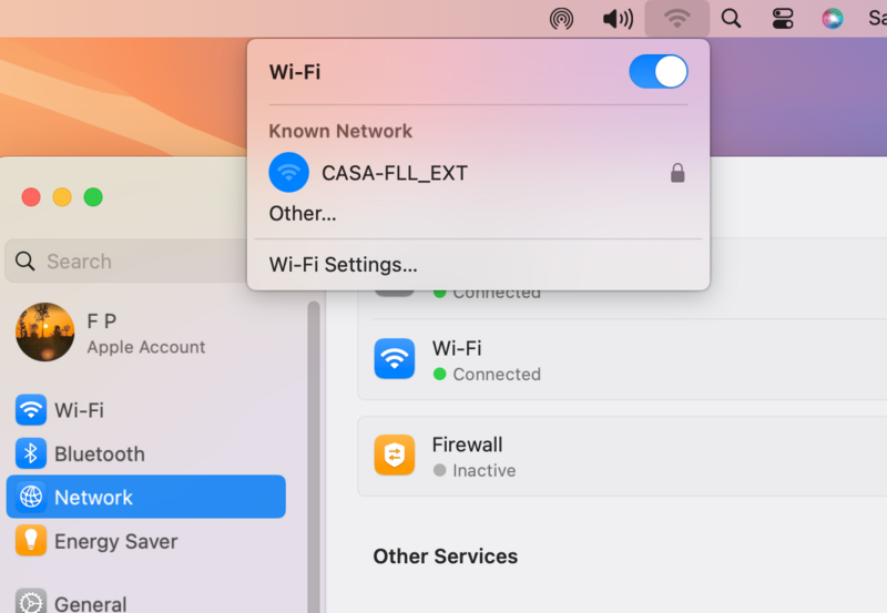

It is possible to download from OCLP sequoia development github two updated kext
AMFIpass and Lilu
https://github.com/dortania/OpenCore-Legacy-Patcher/tree/sequoia-development/payloads/Kexts
both allow to boot without using AMFI=0x80 bootarg
Airdrop works fine

I tried with the version you linked. The WiFi works now. My only problem is that once I apply the OCLP patch, the operating system goes into a kernel panic if I set or remove -amfipassbeta, whereas if I set ampi=0x80, it boots. I can't understand why. This happens with both the old AMPIPass 1.3.1 version and the new AMPIPass 1.4.1 version. Can someone help me understand why?

Sorry… The problem, however, was the outdated Lilu kext.
