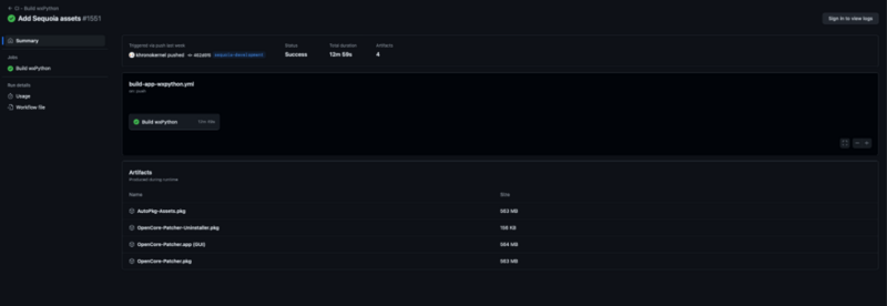

Link to download OCLP Nightly build?

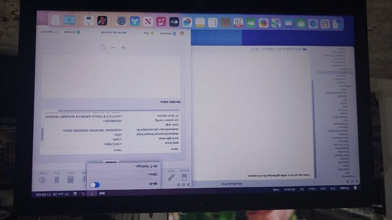

keep it enable and add amfi=0x80 in bootarg system booted after apply root patch but only problem I have I can't seen wifi only way to connect use other and type wifi name and pass to connect
for me airplay and airdrop also work
IMAGE2024-06-28150403.jpg.8a8beb54d179f8b02d9d2dfaab9c5365.jpgIMAGE2024-06-28150405.thumb.jpg.74999c1a84659f8a14a38050a72ad0a6.jpg
On 6/22/2024 at 3:32 PM, morfy said:
No downlaod...
login in git hub after that u can download
