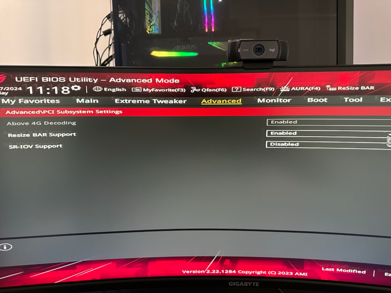

check in bios 4g option and resize bar option and post how they are set please
are you also sure your usb sonoma installer is well done?
I have checked 4g and resize bar and they look as follows,
I have created 2 times my USB installer but I don't know if the problem could be caused by USB?
