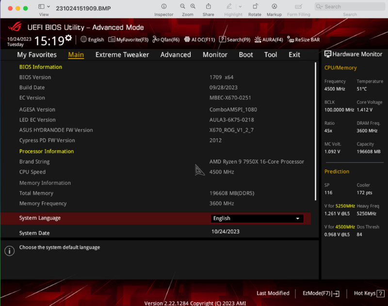

On 10/24/2023 at 12:24 PM, fabiosun said:
Thanks @Lorys89's job now it is possible to boot also with latest 1709 bios 🙂
