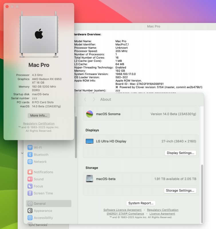

Added in OP Clover R5149 EFI for my configuration
Boots and works as Opencore*
*audio problem is there for AM5 users because clover is not well updated for AM5 platforms
on AM5 it is a pain
No wifi/no ethernet and many others things are wrong on Sonoma for Asus hero
to install (quite easily) I have had to disable ASMedia sata, AMD Sata, WIFI,Ethernet (also disconnecting the cable), thunderbolt....
AMD Kernel Patches work fine (it is mandatory to change Darwin maxKernel value on some patches
no good experience for now 😞
