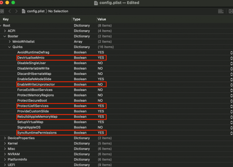

Administrators Gengik84 Posted July 4, 2021 Author Administrators Share Posted July 4, 2021 https://www.macos86.it/topic/3647-clover-quirks-plist-setting/ devi configurare a modo la parte quirk del config, segui la parte CometLake Scarica anche plistEditor, apri il config con questo e segui il resto Link to comment Share on other sites More sharing options...
Support Team Anto65 Posted July 4, 2021 Support Team Share Posted July 4, 2021 Sicuramente i quircks Link to comment Share on other sites More sharing options...
