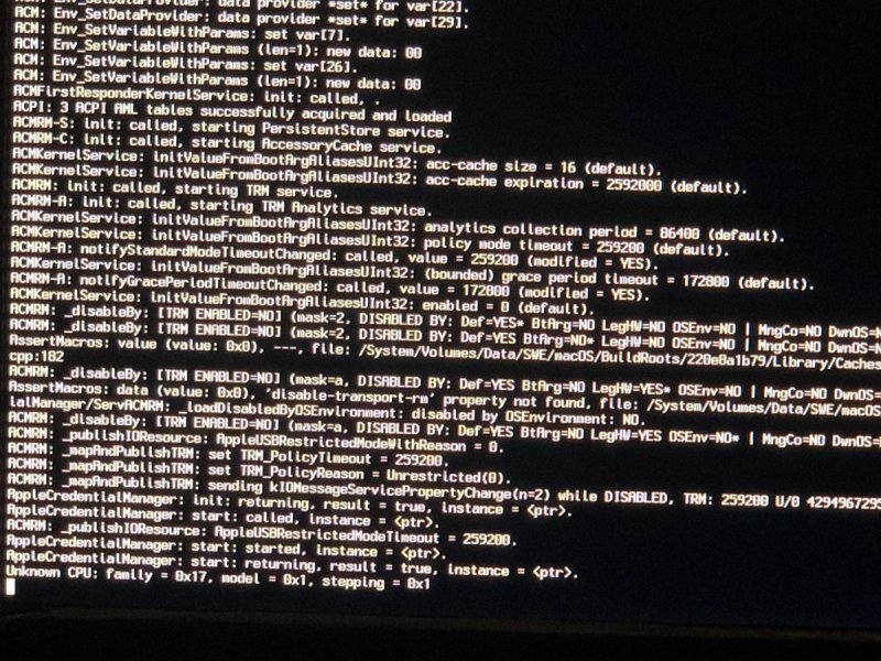

I can not boot any MacOS from 10.13.6 to 12.1 with Clover 5142 now even after repeated reset Nvram ! Any other possibility for this issue ?
774378167_Screenshot2021-12-11at11_53_59AM.thumb.png.e30952e8f1d69f0df6317895df45868f.png
try always to reset Nvram, overall if you use sometime also openCore
Clover 5142 is problematic also here
but sometimes works (after resetting Nvram)
try to download my EFI from my TRX40 OP and use only driver EFi and bootX64.efi , cloverX64.EFi and main kexts I use

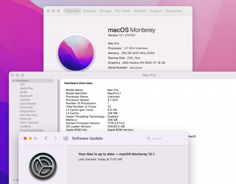

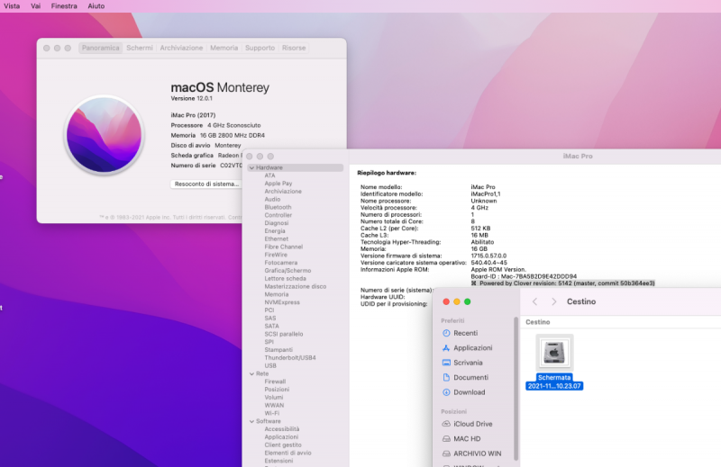

however with 5142 dock animations have a double speed
Wifi/bt card disconnect often
GPU performances are horrible
I am not using Clover because it is unuseful also to open an ISSUE in their GitHub
for them all is working always and problem is only due users errors 🙂
I use Clover only to test something..but latest version is a pain
see here:
Clover 5142:
520981556_Screenshot2021-12-11at12_07_21PM.thumb.png.35b0702357979a158230127a90e6c4bb.png
Opencore 077:

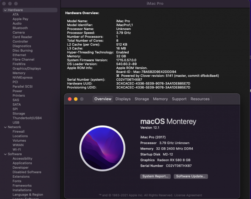

Thank you very much.
Based upon your config.plist with minor modification for my special hardware requirement it can boot Big Sur and Monterey successfully with Clover 5141 again !
config.plist.zipFetching info...
