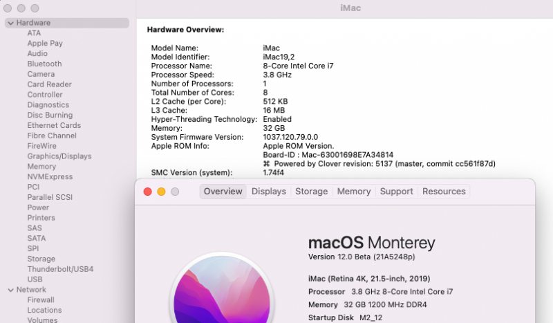

Eventually my Ryzen 1700X can boot Clover 5137 at Monterey without previous issues now. My config.plist attached here:
[Edit]
Your previous config.plists had some typing error such as 10.5 instead of 10.15 which may cause some trouble to boot smoothly.
config.plist.zip

Thanks for your hint which help me to boot Ryzen 1700X smoothly by Clover 5138 now:
[Edit] Besides RestrivtEvents.kext add CPU->Type->String->0x0f01 Clover can show correct name of Ryzen 1700X now !
But no such a lucky by OpenCore 0.7.1 even Number -> 3841 (which=0x0f01 hex) was added in PlatformInfo -> Generic ->ProcessorType
Screen Shot 2021-07-23 at 10.22.57 AM.pngP
Edited by jsl2000

Enabled ProvideCurrentCpuInfo Quirk can disable many patches related to core logical string, but my About this Mac issue still bother me up to now.
Only Clover booting can fix it from Catalina to Monterey beta3 and the same issue occured at High Sierra and Mojave too!
[Edit]
No such an issue in FX-6300 hackintoshs from Catalina to Monterey beta3 booted by Clover or OpenCore.
Unfortunately if ProvideCurrentCpuInfo was enabled my Fx-6300 hackintoshs will got red screen KP on booting Legacy OC.
Edited by jsl2000
