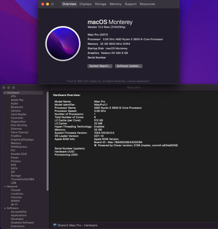

11 hours ago, SavageAUS said:
Ok here is the clover i used to boot Big Sur and i think it booted Monterey B1.
Also my OpenCore that boots Big Sur and Monterey B4.
Clover 5138 EFI.zip 11.41 MB · 7 downloads OpenCore 0.7.2 EFI.zip 11.43 MB · 6 downloads
Hi @SavageAUS
with this clover EFI
insert only in it this config.plist
config.plist.zip
with the help of @AudioGodwho have a X570 motherboards which needs of a working topology patch..we have had success
without this patch he has same your problem with topology error in verbose we see on your verbose (he has a 12 cores 5900x)
571947320_Screenshot2021-07-30at10_31_51PM.thumb.png.9905e1e1535c25f5bea73845ee08eb80.png
so it should pass also for you this error..if so then you can refine better with all stuff you use in your attached here clover working EFI
In clover we can't use new topology patch but algrey old ones work well also in Monterey b4
26 minutes ago, fabiosun said:
Thank you @SavageAUS
i will check your debug log later
was it useful for you old topology patch to have success?
I can’t remember which patches are being used at the moment but they are in my config.plist previously attached.
Thankyou for all your help in getting this working with clover.
I much prefer to use Clover over OpenCore.
Yep you are using patches posted in previous config.

Thank you @fabiosun,@SavageAUS.
Clover's Kernel Patch has a habit, and if you don't add Masks, it may "Borke" or Replase may not "Success".
@iCanaro was having a lot of trouble with that. We found that we didn't need the topology patch, but we re-adopted it when we put it together.
I was also cooperating with @SavageAUS because I couldn't leave it alone.
At @SavageAUS on Insanely forum, we tried a lot. In the end, it was great to have someone like you who knows a lot about AMD patches.
The good news is that the @SavageAUS patch works.
Can I post this result to AMD fans in Japan? .. Of course, the credits are @fabiosun and @SavageAUS.
It seems that the important part of SMBIOS has been omitted, so it will be a great reference as it is.
Of course, depending on the OS, the possibility of disabling patches is also mentioned.
