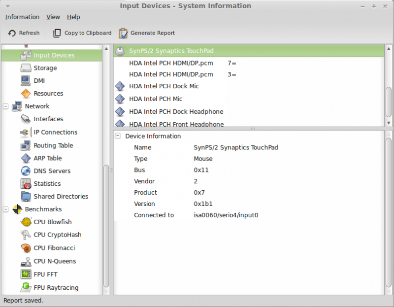

Questo mi restituisce lshw -
    <node id="pnp00:03" claimed="true" class="generic">
     <product>PnP device SYN1f00</product>
     <physid>5</physid>
     <configuration>
      <setting id="driver" value="i8042 aux" />
     </configuration>
     <capabilities>
      <capability id="pnp" />
