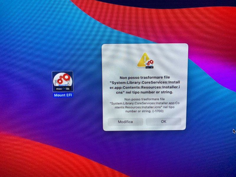

38Nic Posted April 29, 2021 Author Share Posted April 29, 2021 Ok scaricato Mount Efi ma mi da questo errore all’apertura.. Link to comment Share on other sites More sharing options...
Support Team Anto65 Posted April 29, 2021 Support Team Share Posted April 29, 2021 ProperTree-master.zip IntelMausi-1.0.5-RELEASE.zip hackeck copialo nelle app lo apri sopra sulla barra " tool " c e' esp mounter Link to comment Share on other sites More sharing options...

Administrators Gengik84 Posted April 30, 2021 Administrators Share Posted April 30, 2021 19 ore fa, 38Nic ha scritto: Ok scaricato Mount Efi ma mi da questo errore all’apertura.. Scusa ma quando scarichi se vedi una versione più recente, scarica ovviamente quella... ossia la 2.0... Link to comment Share on other sites More sharing options...
