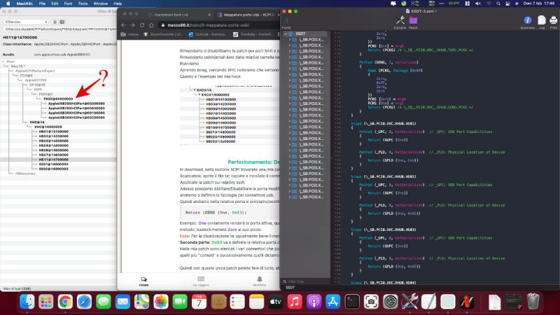

Support Team iCanaro Posted February 7, 2021 Support Team Share Posted February 7, 2021 Il 5/2/2021 at 16:59, antuneddu ha scritto: figata ,per me e' tt nuovo disabilitato il kext riavviato ubport funzionanti yeah grazie visto che sei capace e non ti spaventi, ora che hai mappato tramite le acpi, puoi definire tipo di porte grazie a questo https://www.macos86.it/files/file/71-patch-usb-connector-type/ usa macials 158_G che trovi qui in download patcha ssdt caricandogli il txt poi sostituisci a seconda se USB 2.0 USB 3, internal il risultato sarà questo: Link to comment Share on other sites More sharing options...
Support Team Anto65 Posted February 7, 2021 Author Support Team Share Posted February 7, 2021 soldi e paura mai avuti 🤣 infatti adesso vengono viste tutte internal ,sulla guida mappatura usb di gengik c ' era anche il discorso connettori onestamente mi e' sembrato to mutch 🙂 non ero pronto .Ritieni sia una cosa da fare ? Link to comment Share on other sites More sharing options...
Administrators Gengik84 Posted February 7, 2021 Administrators Share Posted February 7, 2021 Certo, definisci i connettori Link to comment Share on other sites More sharing options...
Support Team Anto65 Posted February 7, 2021 Author Support Team Share Posted February 7, 2021 Comandi 😊, ovvio domanda stupida la mia Link to comment Share on other sites More sharing options...

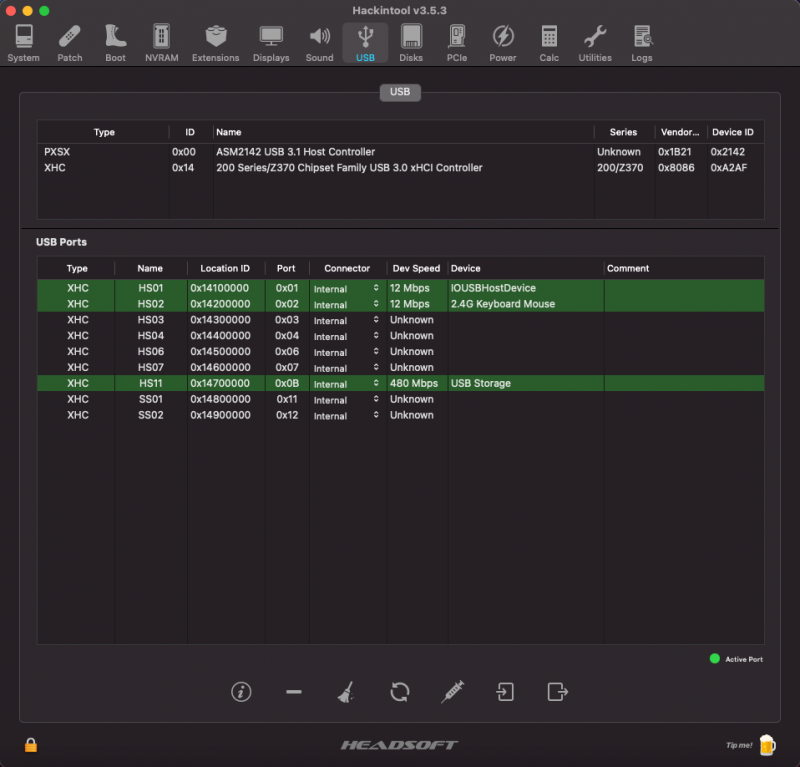

Support Team Anto65 Posted February 7, 2021 Author Support Team Share Posted February 7, 2021 🤔 come faccio a capire quali sono le 2.0 e 3.0 confused Link to comment Share on other sites More sharing options...
Support Team iCanaro Posted February 7, 2021 Support Team Share Posted February 7, 2021 le PXSX non le toccare HS --> USB2.0 sostituisci Return (GUP (One)) con Return (GENG (One, 0x00)) SS --> USB3 Link to comment Share on other sites More sharing options...
Support Team Anto65 Posted February 7, 2021 Author Support Team Share Posted February 7, 2021 immagginavo 🤣. solo he no trovo da nessuna parte hs ss o sono OTtuso Link to comment Share on other sites More sharing options...
Support Team iCanaro Posted February 7, 2021 Support Team Share Posted February 7, 2021 2 minuti fa, antuneddu ha scritto: immagginavo 🤣. solo he no trovo da nessuna parte hs ss o sono OTtuso allarga la barra laterale di sinistra sino a che non vedi i nomi per intero Link to comment Share on other sites More sharing options...
Support Team Anto65 Posted February 7, 2021 Author Support Team Share Posted February 7, 2021 la tastiera perde colpi ogni tanto sorry, trovato HS SS tramite hackintool Link to comment Share on other sites More sharing options...
