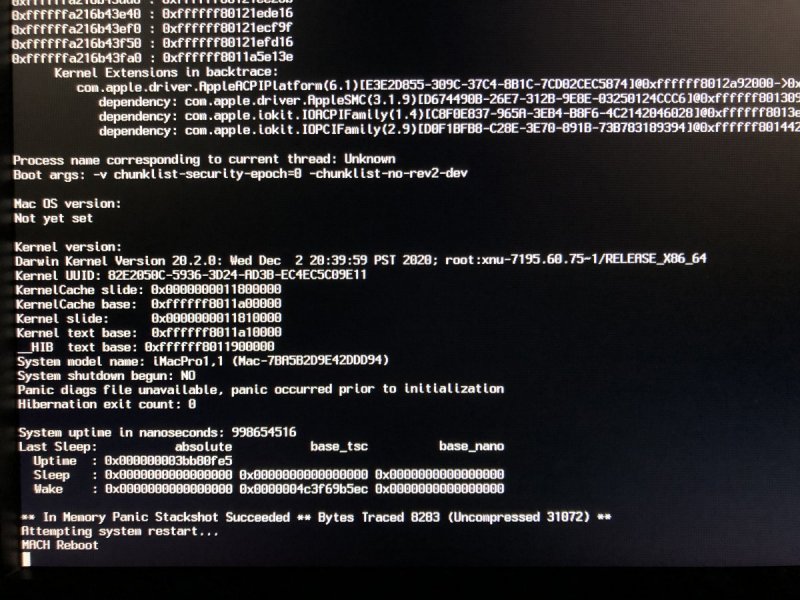

Hello,
I simplified the kernel patch as much as possible on the advice of @fabiosun
but I find myself with the obligation to keep the argument :
cpu_topology_sort -disable _x86_validate_topology
1261068138_Capturedcran2020-12-0317_34_12.thumb.png.988715b7a75b9bac9b3c7b34eb769b2d.png
Is it related to the AMD 3960 X processor or the motherboard ?

@fabiosun
I tried your config.plist by removing the argument: cpu_topology_sort -disable _x86_validate_topology
It’s the same kind of mistake.
My EFI from the first post is working perfectly fine.
I'm just looking to simplify the kernel patch.
I have to keep the argument: cpu_topology_sort -disable _x86_validate_topology
Otherwise I get the kind of error message like the previous post: In memory Panic.....

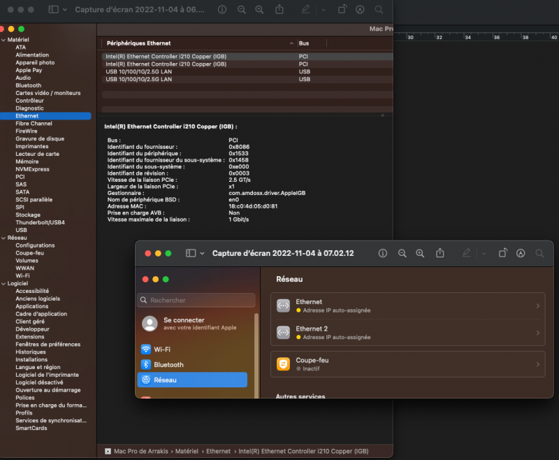

@mbarbierato  @Lorys89
There is a better on my configuration.
The kext is well recognized (see Capture) but as soon as I plug in the cable the connection is not established.
2101627942_Capturedecran2022-11-04a07_16_10.thumb.png.efc1e558fe0a073f7a7b59eb0fb4c730.png
On the other hand, the kext no longer causes a restart when I turn off.
My hunch is that you are not very far from solving the problem.
Attached is the generated log.
Arrakis I210 Trx40.txt.zip

Have you connected the lan cable to both 2 cards?
If you do try to connect it as 1 only.
@Lorys89
Just a note, normally when there is no ethernet cable to connect. the Lan port should display: not connected (with the red circle)
Currently without cables connected on the two lan ports are in: self-assigned IP address. (with the orange circle)
