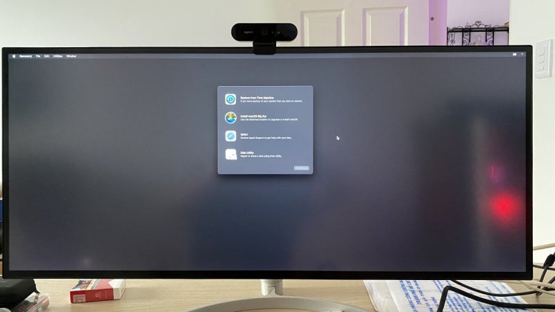

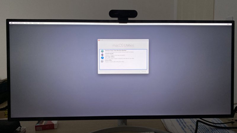

I got another problem, with the wired mouse and kb, after loaded to the macOS Recovery page, the mouse and the kb works just fine (moving freely the mouse, caplock/number on kb on/off correctly until I try to click on something it's hanged, all kb and mouse. Any ideas?

Thank you very much for the EFI, for some reasons, it's keep hanging, I attached here again with the debug.
There's EFI work, that's the one work with Catalina,  I just keep it "as is" for Big Sur, and it loaded, even much faster than Catalina, but the Mouse and KB issue retained, it's start hanging after a certain time, like 2 minutes.
I attached here the EFI that work with Big Sur, please have a look and help to figure out what the problem, also the picture of Big Sur loaded and hanged with the. mouse and kb.
Work with Big Sur with debug.zip fabiosun latest with debug and panic.zip

PS: In the first 2 minutes, both wired and wireless mouse and kb work freely, it just started to hang after that certain time.

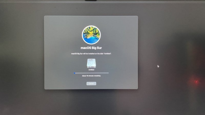

i have changed all the physical USB with KB and mouse, things happened the same.
so, right now I'm stuck at the installation screen right at "16 minutes remaining " as screenshot was sent before.
Could you please help to disable something to make it works first, then the installation can be done, then we can fix it after get into the main screen.

are you sure your USB installation pen is fine?
how did you build it?
I'm pretty sure the physical USB installation disk is fine,
I downloaded Big Sur from apple, build the installer with apple command ( can't remember), and EFI built as told.
Take your time Fabiosun, I can wait with fully hope🥰
