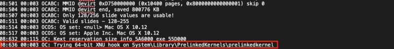

While waiting for Monterey patches, I decided to regress and try booting into Mojave as an exercise. But, I can't seem to get it to work. I've tried old settings that I thought worked a year or so ago, including OC v061 as well as v070 with its various updates.
In verbose mode, I only see  the following on screen and then computer freezes:
End SetConsoldeMode
Start OpenKernelRootVolume
End OpenKernelRootVolume

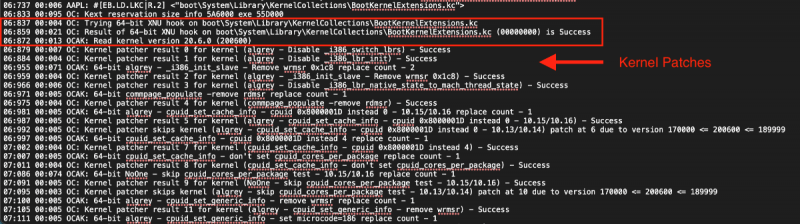

When looking at the debug error code, during the Mojave boot, the stoppage occurs at the XNU hook stage (shown in spoiler with comparison to same area during a successful boot into Big Sur). Once the XNU hook is successful, then the kernel patches are loaded, so this freeze occurs just before the Kernel Patch stage.
Any ideas how to fix?
Mojave boot stops here:
same position during Big Sur boot:

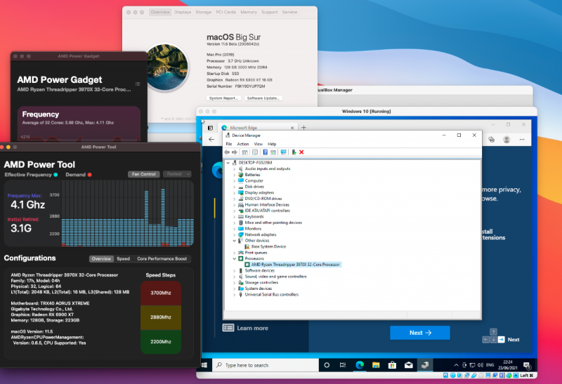

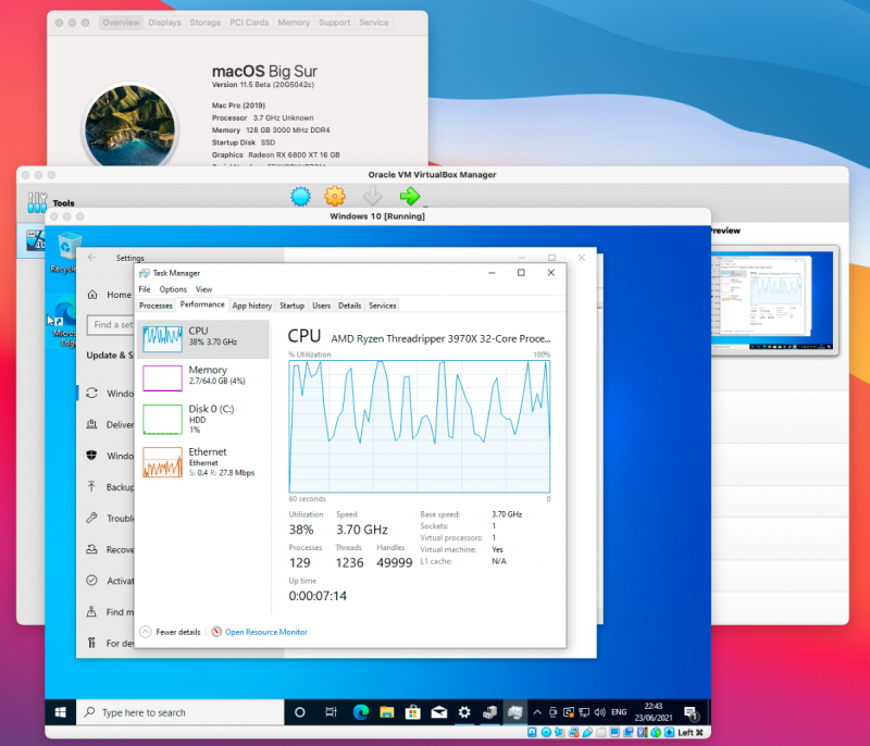

As I was on day release from hospital today, I updated my machine to the latest OC release (0.7.0) and the latest BS Beta (11.5 beta 3). Whilst in hospital I had fixed a friends laptop that was continually crashing be wiping it and loading the latest Windows, Win10_21H1. As I had the ISO on a USB drive I decided to try a VM on the Threadripper, thinking it wouldn't work.
My copy of VM Fusion was very old, V6, so I downloaded the latest VirtualBox to play with. I know it isn't the best VM software but it is free.
It was with great surprise then that a Windows VM was up and running in a matter of minutes. No having to try and patch anything or anything else. I have always had SVM enabled in my BIOS setup so I didn't even have to change anything in there either.
So it works. I haven't tried passing through the RX 6900 XT or RX 6800 XT through to it yet, I was just astonished that it worked straight away.
  • Like 3
6 hours ago, Ploddles said:
I've always read on here that you cannot run a Windows Virtual Machine on macOS on our Bare Metal Threadrippers.
glad you're back home!
  • +1 2
I only used the single core as an initial install to see if it would work. It is good that we now have another option to run a Windows program without rebooting.
