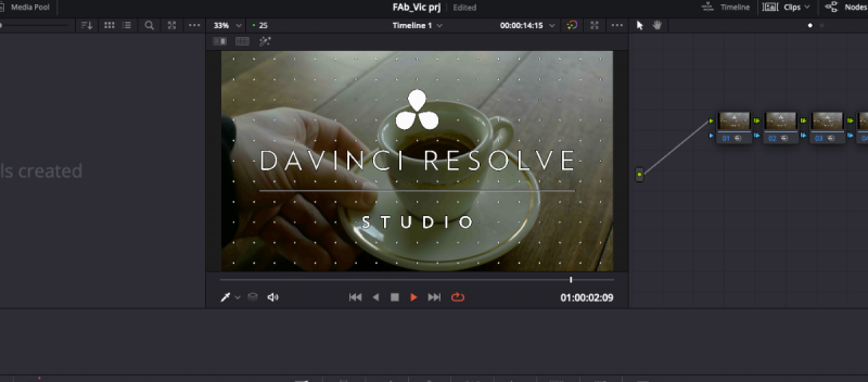

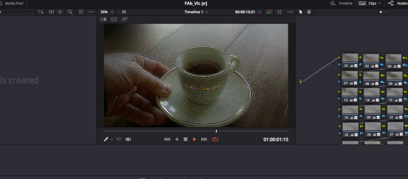

I removed WEG kext and pikera boot arg  and still no change . This is what I get when  running 66 blur notes
2010345524_ScreenShot2021-05-11at11_33_56AM.thumb.png.7429c5c9b2ca84c12149dfb7a718969f.png
With 6 TRN this is my results.
