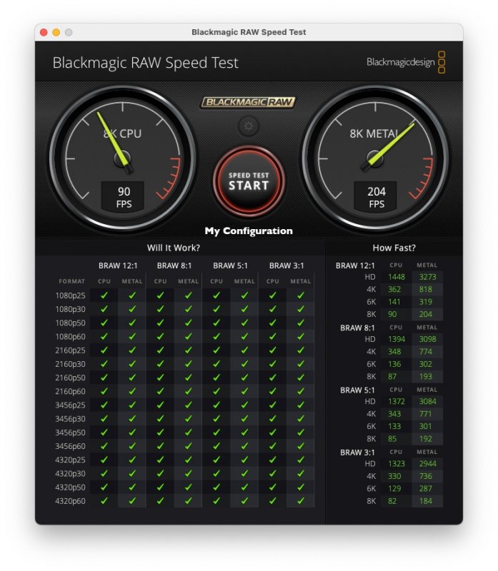

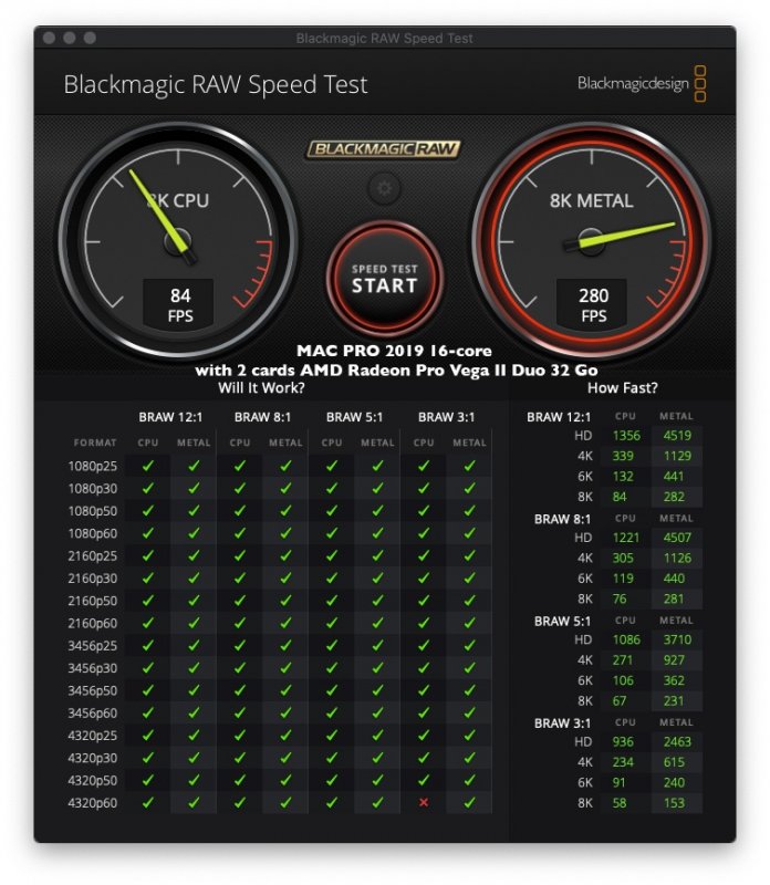

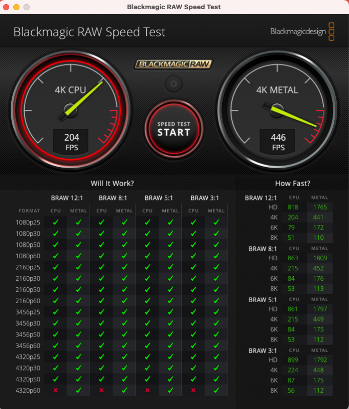

@valmeida
Great to have done the tests. according to the Blackmagic Raw test. Your current config with the 6900XT gives a hell of a slap in a 2019 macpro.
there is a small problem with the Blackmagic Raw test.
When you look at the counters, it's an impressive score but when you look at the values in the how fast columns it's way below.
The 1st screenshot attached is a 2019 MacPro
16 cores with 2 AMD Radeon Pro Vega II Duo 32 GB. And the second screenshot is my current configuration
955019628_MacPro20192cardsAMDRadeonProVegaIIDuo32GoX22.thumb.jpg.8fc209de0d8db86c2f7ec2acc723a6b7.jpg776196999_RYZENTOSH2GPU.thumb.jpg.8f12e0ea5993607ec5c2503a2e4c5ce2.jpg

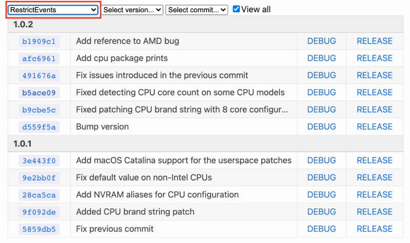

On 5/5/2021 at 12:27 AM, Arrakis said:
@fabiosun

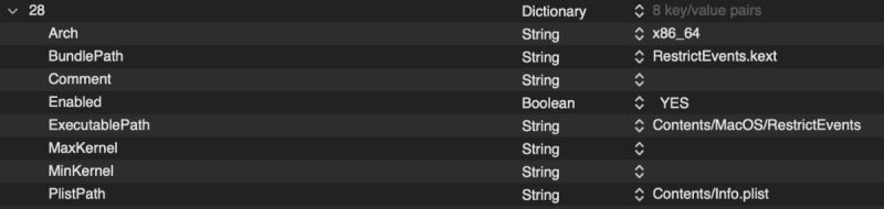

is there the problem with the RestrictEvents kext ?
If you go to this web site (here it is RestrictEvents), you can get the latest commits of most things OC. By choosing the pop-up (highlighted in red below), you can move between the various kexts and OC builds.
When I run the latest RestrictEvents, the Memory section is still working. I'm normally not using this kext after modifying the Memory section of OC. I am not seeing any error issues with the PCI section (which is not working, and for which I've not yet found any solution).
366990251_ScreenShot2021-05-06at8_48_29AM.thumb.png.082ee3fdb106b9a609857472d7f92770.png
Edited by iGPU
@iGPU
it's exactly the same for me.

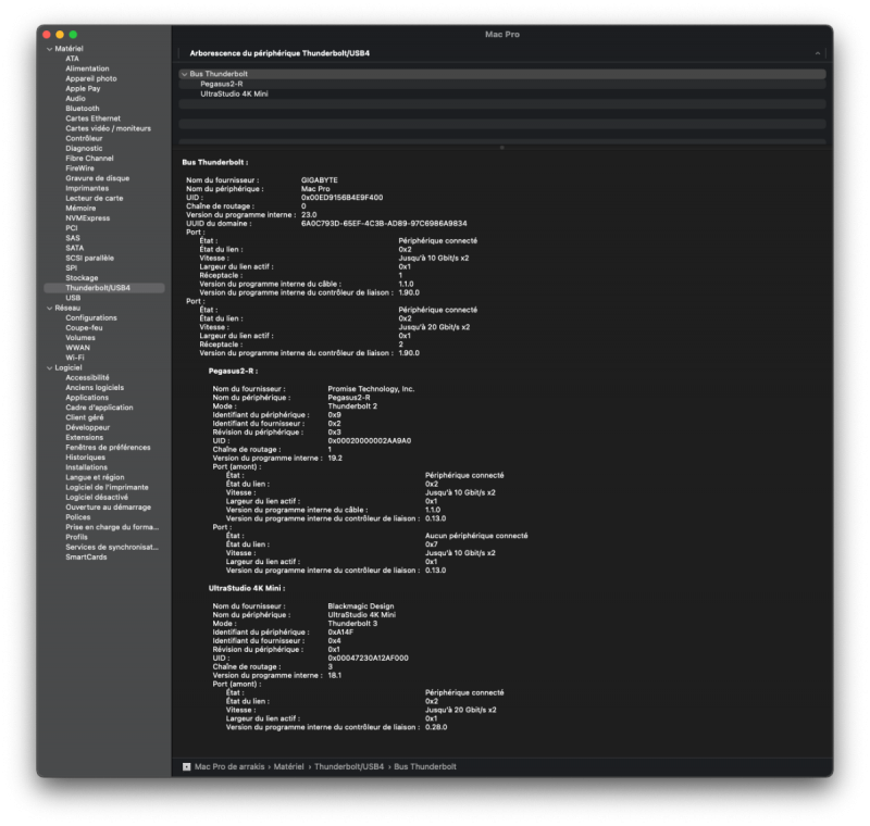

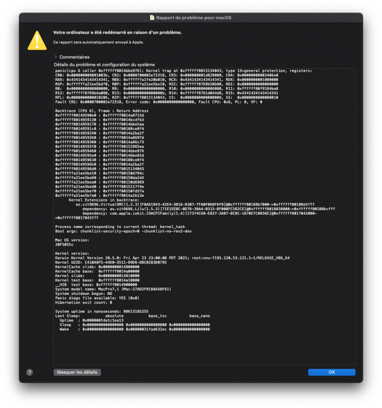

@fabiosun@iGPU
I installed Big Sur 11.4. Beta 2.
I did a clean install in 11.3.1 and then directly to 10.4. beta 2
Unlike you, I do not have the error message on the locations of the PCI cards.
On the other hand, I have a mess of kernel panic.
After 1 minute it's a black screen and a complete restart of the PC
I am using the same EFI as for version 11.3.1
Memory mapping is manual.
I put the kext whatevergreen back on because while loading Osx there are display artifacts on the boot screen (HDMI) and also the two screens are reversed on every boot.
I have no WEG argument.
2038383334_Capturedecran2021-05-08a08_45_42.thumb.png.d0ca47b2176c02746140aed0b955fca3.png

Absolutely no problems installing Beta 11.4.  OS loads without problems.  This is after logging on the session about 1 minute after the screens go black and the pc completely reboots with the Kernel panic report each time at the next log session.
1 hour ago, Arrakis said:
@fabiosun
It is VirtualSMC which is in backtrace, try another version or FakeSMC instead.
@Arrakis
I think you're having a TB-USB kernel panic (there is a new firmware to flash onto the card that stops kernel panics with BS > 11.3, but beyond scope of this thread;  see here for more details). Remove the TB card, re-boot and if no more freezes, then it was the TB AIC's USB generating the kernel panic.
The screen artifacts during boot, when WEG is disabled, is normal and of no concern. WEG simply suppresses them (they began with Catalina).
Edited by iGPU

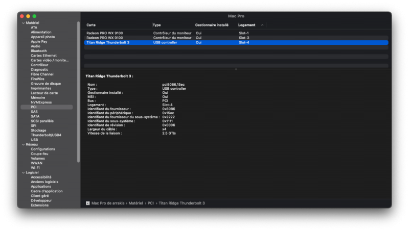

@IGPU it's a problem with the thunderbolt card but I'm not sure it's the flash version because when I disable SSDTs (SSDT-TBOLT3-NVM23 & SSDT-DTGP.aml).
I don't have Kernel panic anymore. The system can see the card and the peripherals plugged into it. (See Screen capture) but inoperative.
The flash I used was TitanRidgeNVM23-E64Fr.
329397297_PCI.thumb.png.9344ed5658efc9125a23186846473b86.pngTHUNDEBOLT.thumb.png.8bf7726001a147836406a5ca7c884c59.png
Do you have any idea what's wrong with these SSDTs? (both are from the EFI Meina22 so you have to work together for the proper functioning of the hot plugging)
