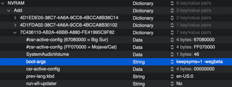

valmeida Posted April 14, 2021 Share Posted April 14, 2021 Im having a weird issue were my machine when is idle after 5 minutes it freezes and reboots. I have no screen saver , turn off display to never and prevent computer from sleeping checked . Does anyone have any ideas what it could be ? Link to comment Share on other sites More sharing options...
Supervisor fabiosun Posted April 14, 2021 Author Supervisor Share Posted April 14, 2021 Check if in your config you have dummypowermanagement on or off and try to switch it on if disabled or viceversa @valmeida Link to comment Share on other sites More sharing options...
Moderators iGPU Posted April 15, 2021 Moderators Share Posted April 15, 2021 @valmeida, You've listed an "AMD Series VII"; I'm assuming this means a Radeon VII, same as I'm using. The 5700 and VIIs have had issues with WEG, even on the Intel side of things. Such problems led me to add a boot argument: "-wegbeta". Try adding this to your "boot-args" section to see if this stops the freezes. Another test is simply to disable WEG and see if this stops the freezes. Link to comment Share on other sites More sharing options...

valmeida Posted April 21, 2021 Share Posted April 21, 2021 On 4/15/2021 at 11:22 AM, iGPU said: @valmeida, You've listed an "AMD Series VII"; I'm assuming this means a Radeon VII, same as I'm using. The 5700 and VIIs have had issues with WEG, even on the Intel side of things. Such problems led me to add a boot argument: "-wegbeta". Try adding this to your "boot-args" section to see if this stops the freezes. Another test is simply to disable WEG and see if this stops the freezes. I sold the Redon 7 I pull out the Vega 64. It seems to only happen when the monitors fo into sleep mode . I will test it today to confirm , Link to comment Share on other sites More sharing options...
