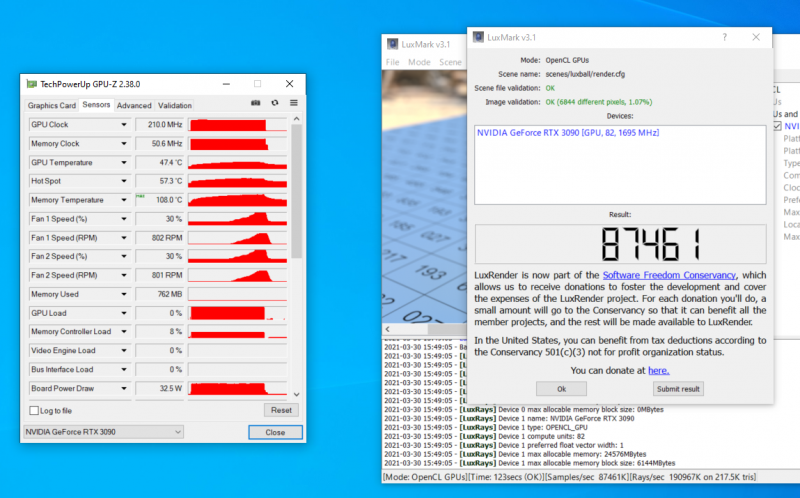

on luxmark great results indeed
I knew that resolve would be use them separately..but I have no more a dual gpu rig by years ( I have had 2 Titan Z gpu, for  gpu in a dual GPU system)
Never used in SLI condition

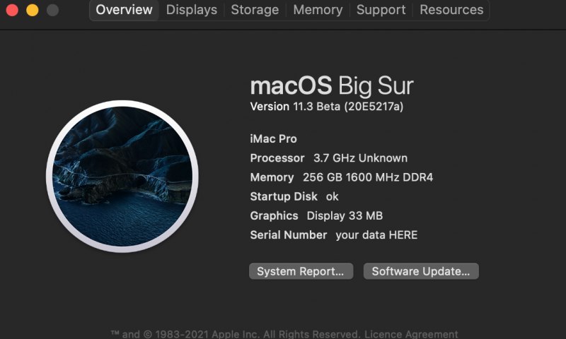

I just upgraded to OpenCore 0.6.7.
I was pleasantly surprised to see the name of the processor in the information window. Even if it's not the right one and the frequency is better than seeing "unknown".
The 2021 Mac Pro is my "work". 😅I know it's cosmetic information but it's nicer ...😀
Of course my SMBIOS is iMacPro1,1.     Here is my EFI.
