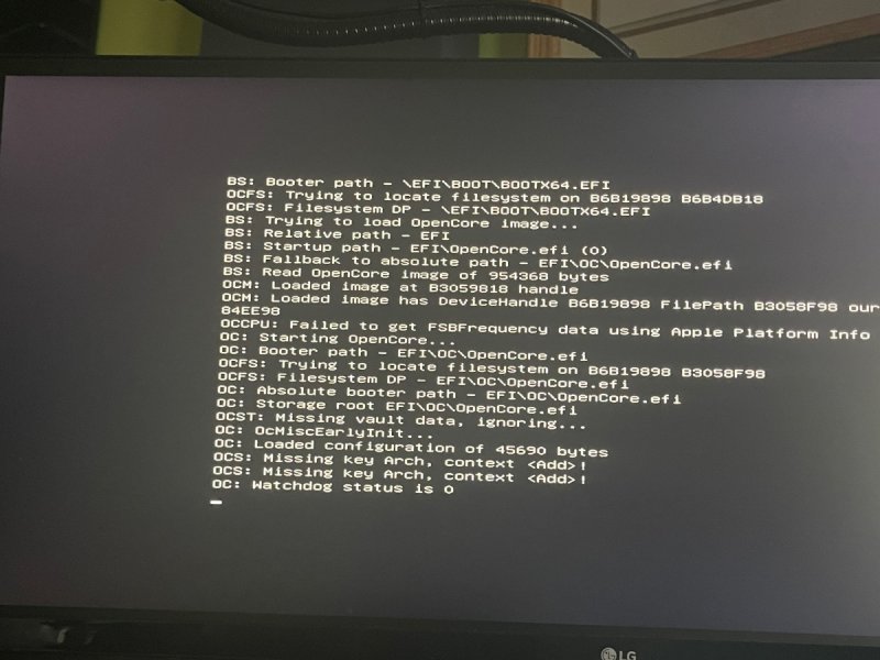

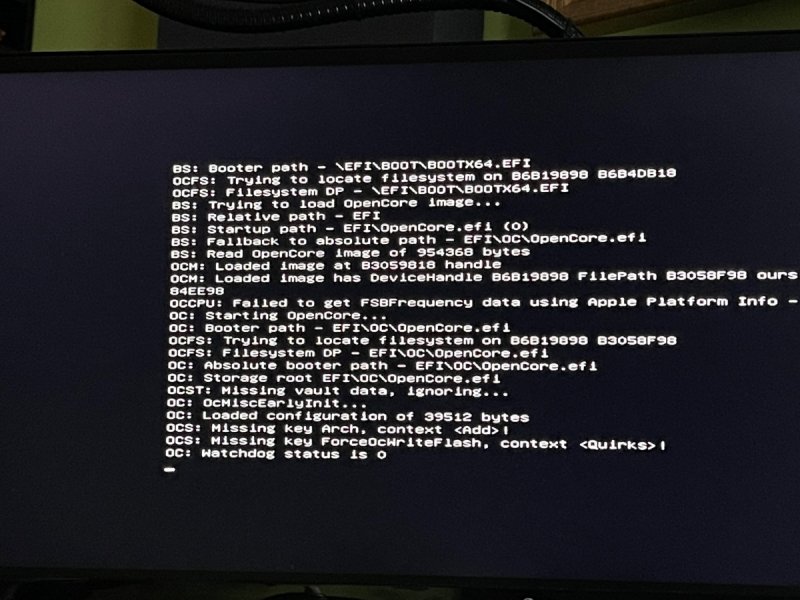

I tried to update to OpenCore 0.7.4 yesterday still with Big Sur and the system didnt boot anymore. I downloaded the new package of OpenCore, put in the kext files from the working one and the Config.plist. That is how its supposed to work?
@Arrakis I made the recommended  changes thank you. I have a couple of questions
1. what sample config do you use to compare is the generic one that gets downloaded or one specific  for AMD TRX40?
2. i still get some errors when open core loads before I get the screen which drive to boot from   BIG SURE MONTERAY etc
3. When running OC validation I still get an error missing context in serialization.

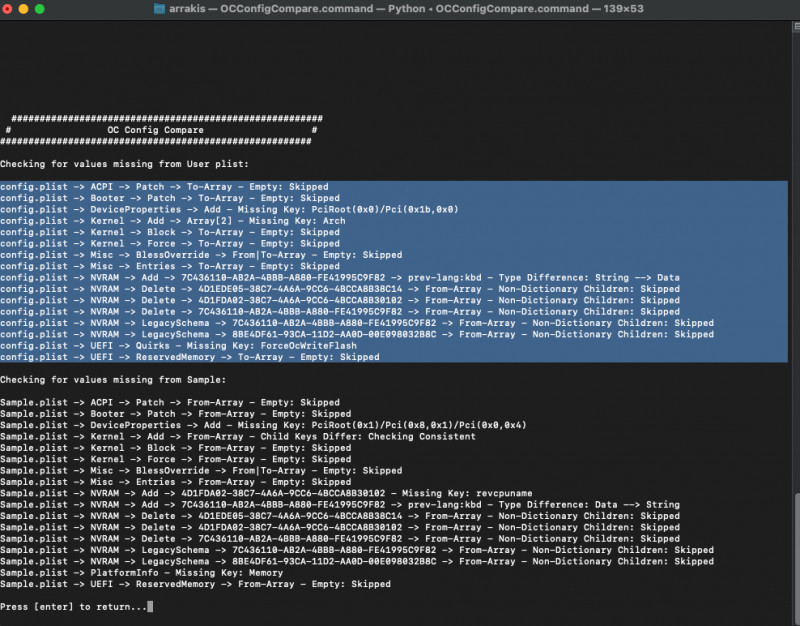

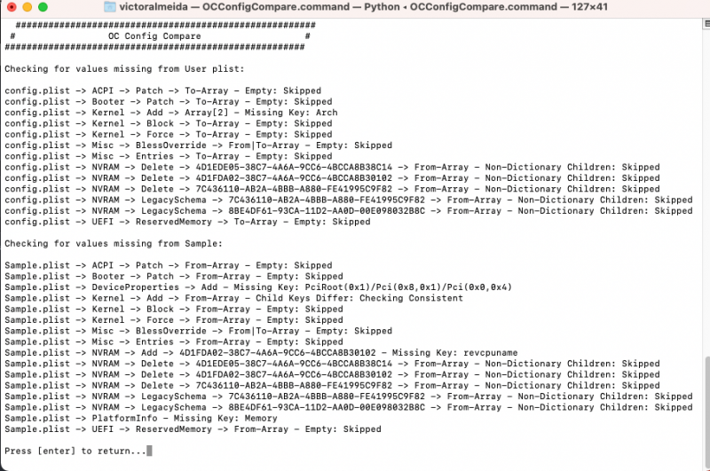

1289330719_ScreenShot2021-10-24at5_22_55PM.thumb.png.7b47fa5c34eb482ffded48a3558cc455.pngconfig.plist.zip``
8 hours ago, Arrakis said:
@valmeida
I don't know what happened, I tried again with a newer version of OCConfigCompare and I find the same result as you.
I am using the sample.plist delivered with the OpenCore 0.7.4 version.
There is no example specific to the TRx40.

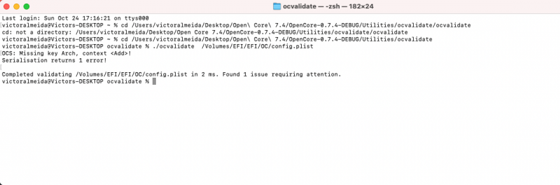

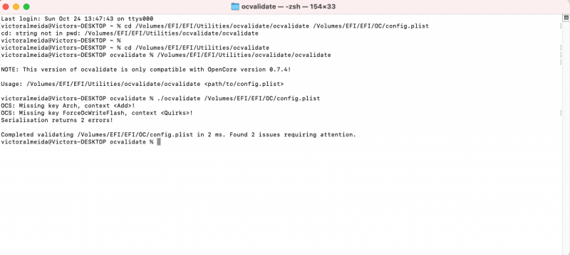

1320900143_ScreenShot2021-10-24at1_54_13PM.thumb.png.781b7618a707d1eae02e63048ce7bdc4.pngIMG_1281.thumb.JPG.7bd649369f4e755d72e81e16a4772c13.JPG
Im trying to update to open core 7.4 during the boot I get this error when running OCValidate I get this response . Any one know  how I can fix this?
I have taken this EFI and updated to 075
add only your kext and try
your SMBIOS and memory settings and all your config settings are there
EFI 3.zip
It works perfectly thanks you. One thing  I can not get my Aquatina to initialize on Monterey 😞 it works on Big Sur but not  on Monteray .
