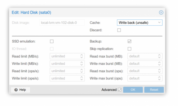

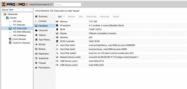

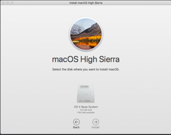

ouch, as murphy said, "solutions generate new problems" I have an OSX vm configured as in the picture below, I have two drives IDE for  clover and the OSX CDROM (mounted as an ide HD of 2GB) and the virtual disk of 32GB defined as a SCSI disk. Now (Fig 2) when OSX shows me the choice of HD on which to install itself, it only offers me the choice of a 2GB HD, which I need to speculate, it is the HD in which I mounted the OSX iso, it has no visibility of the 32 GB HD I created and associated to the VM. The HD configuration is listed in fig 3. Any idea?
Quote
ehmm
have you formatted it in disk util?
then..why scsi?
I never tested scsi..but I think it is not your problem (also never checked backup, some time SSD emulation but it is not relevant @Renatofor your disk miss!
see also If you see it here :
oops sorry, I wrote SCSI, I meant Sata (being tired plays with your mind 🙂  ).  The installation is now done, I am getting a problem while authenticating it,  once I put in my apple id and password it falls into an error because it cannot connect to icloud. The error is one I cannot recover in any other way than reboot. I cannot try whether the network works as I do not get to use the OS but I presume it does otherwise I would have never finished the installation as I believe there was  plenty of stuff to download.
@Renato i do not understand: "(being tired plays with your mind 🙂  )"
for your icloud access problem instead..you have to fill your config with some data in SMBios.plist part….
so have you formatted now your previous unseen OSX disk? 🙂
(being tired plays with your mind 🙂  )"   just means, It was an error I made for being tired. I have formatted the previously unseen HD, will look for the data to be added in the SMBios. That is a strange one, When I installed a hackintosh system I do not remember performing that action.

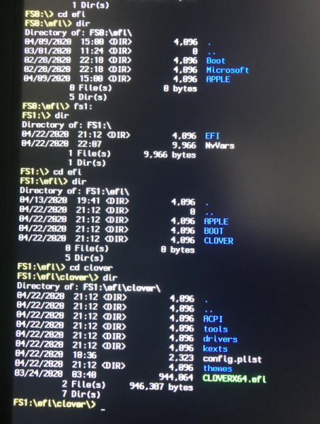

I went to check the config.plist of a hackintosh I have to see  what it is you are referring to, however, I do not understand how I would access config.plist of the system in my VM as in order to access it I would need to have access to the OSX system and mount the EFI partition. Is there a way to mount that partition outside of osx, before it boots? or more in general, how do you access that config.plist? or do no need to access the config.plist in the clover.iso (I used the one downloaded by your tool) how can I acheive that?
Hi Renato
have you ever booted on your rig with Proxmox?
If so you have to modify it as usual method with a plisteditor or a tool to do it easily.
Modify it in this way update in real time your uploaded ISO in proxmox
To start it is enough to use VM Assistant clover iso.
So your task should be to boot with default iso you achieve with VM Assistant app
Then modify it inside OSX environment as usual
If you never booted in OSX and you reach Clover boot menu, you can open shell window from it and try to modify your config.plist by hand.
First of all understanding where it is located (maybe fs0:)
My fsX drive address is probably different of your and I advice to install simply and then add stuff you need (shell config modifying is more complex and It is not a scope of this guide)

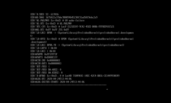

Hiya, I have some issue relatively early, pre-install, during Clover boot. I'm an experienced hackintosher, and the information I found was that it's a memory allocation issue, which people solve by moving RAM sticks. I changed the assigned RAM from 125GB to 64GB to no avail. It turns out Clover 5007 may have this issue, but a newer version doesn't. I would like to use OpenCore straight away, or the most recent version of Clover. How do I attain a .iso file that can be used as such? I'm not sure how to make an ISO out of a Clover / OpenCore EFI folder.
My problem (10.15.4-related with Clover, apparently), see screenshot.
PS: 11.05GB RAM @ 0MHz hahaha
Edited by AllubzV
