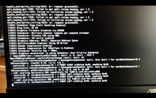

marzillo Posted April 15, 2020 Author Share Posted April 15, 2020 Con il tuo comando si ferma qui Link to comment Share on other sites More sharing options...
Administrators Gengik84 Posted April 15, 2020 Administrators Share Posted April 15, 2020 Sostituisci Archivio.zip Link to comment Share on other sites More sharing options...

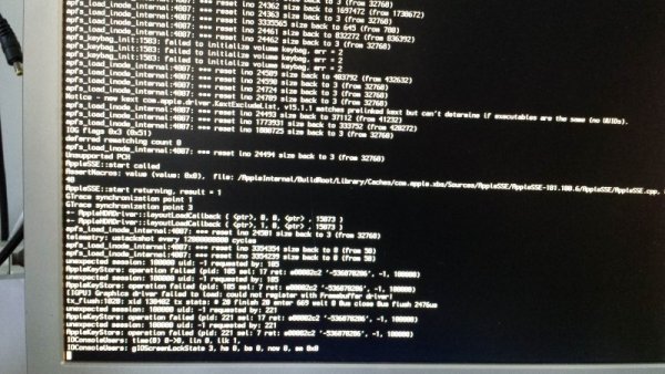

Administrators Gengik84 Posted April 16, 2020 Administrators Share Posted April 16, 2020 prova a sostituire config.plist.zip Link to comment Share on other sites More sharing options...
marzillo Posted April 16, 2020 Author Share Posted April 16, 2020 Si ferma qui Link to comment Share on other sites More sharing options...
