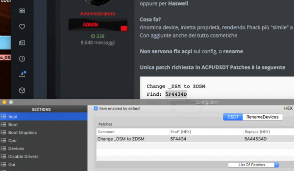

Supervisor. foskvs Posted November 19, 2019 Supervisor. Share Posted November 19, 2019 Sicuro di aver copiato la patch DSM correttamente? Link to comment Share on other sites More sharing options...
Support Team iCanaro Posted November 19, 2019 Support Team Share Posted November 19, 2019 🙄😱 EFI corretta alla grappa EFI.zip 1 Link to comment Share on other sites More sharing options...
Supervisor fabiosun Posted November 19, 2019 Supervisor Share Posted November 19, 2019 beh dai manca poca roba 🙂 Link to comment Share on other sites More sharing options...
Paolo-Sp Posted November 19, 2019 Author Share Posted November 19, 2019 9 minuti fa, iCanaro ha scritto: 🙄😱 EFI corretta alla grappa EFI.zip 3 MB · 1 download Ma ero sicuro di aver scritto 5F4434D ma... è veramente strano, anche in quello che tu mi hai messo online poco fa io non vedo la D finale... che succede? La metto e poi scopare quando chiudo !!! Link to comment Share on other sites More sharing options...
Supervisor. foskvs Posted November 19, 2019 Supervisor. Share Posted November 19, 2019 Ah, già. Non è colpa tua. È un errore nella guida. La stringa corretta è 5f44534d 1 Link to comment Share on other sites More sharing options...
Support Team iCanaro Posted November 19, 2019 Support Team Share Posted November 19, 2019 in effetti ho controllato, pure da me non rimane la modifica.. elimina la riga e fanne una nuova per intero Link to comment Share on other sites More sharing options...
Supervisor. foskvs Posted November 19, 2019 Supervisor. Share Posted November 19, 2019 Modifico il post sulla guida di @Gengik84 1 Link to comment Share on other sites More sharing options...

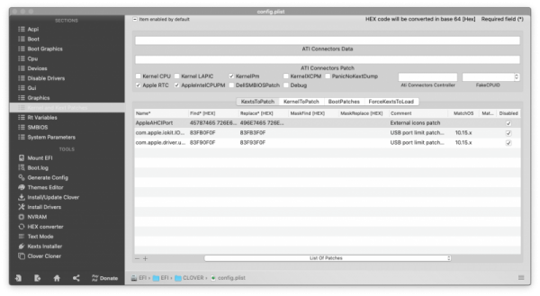

Paolo-Sp Posted November 19, 2019 Author Share Posted November 19, 2019 Inserendola manualmente non prende la D, devo inserire la riga dall'elenco sottostante "List of...." Strano xo !!! Link to comment Share on other sites More sharing options...
Supervisor. foskvs Posted November 19, 2019 Supervisor. Share Posted November 19, 2019 È un controllo di Clover Configurator. Giusto che ti succeda. Link to comment Share on other sites More sharing options...
Paolo-Sp Posted November 19, 2019 Author Share Posted November 19, 2019 Perfetto, ora funzione Ancora un grazie a tutti Appena ho tempo faccio anche la mappatura delle USB 1 1 Link to comment Share on other sites More sharing options...

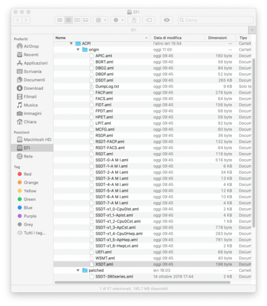

Paolo-Sp Posted November 20, 2019 Author Share Posted November 20, 2019 Rieccomi a chiedere aiuto... Sto cercando di fare SSDT per le porte USB ma dopo il DUMP con F4 non trovo il file che le elenca ... vedi allegato Link to comment Share on other sites More sharing options...
Support Team iCanaro Posted November 20, 2019 Support Team Share Posted November 20, 2019 devi aprirli con MaciASL non avendo nel nome xh non si capisce bene, ma dovrebbe essere uno tra SSDT 4, 5, 6 allegale qui assieme a: Nota 4 - Mappature delle USB: per eseguire tale operazione occorre che il sistema abbia tutte le USB attive con USBIjectall + Port Limit Patch (per i notebook solitamente basta USBInjectall) poi armati di pendrive USB 2 e 3 si avvia ioreg e si infila ed espellono le pendrive in tutte le porte presenti, si prosegue con ioreg -> file -> save as si salva, si comprime e si posta nel proprio thread o in quello dedicato assieme alle ACPI estratte ed eventualmente la EFI senza all'interno la cartella APPLE o Microsoft che appesantiscono il tutto e non servono a niente. Link to comment Share on other sites More sharing options...
Paolo-Sp Posted November 20, 2019 Author Share Posted November 20, 2019 (edited) io mi aspettavo un file xh_rvp08 oppure xh_rvp10..... ora li vedo tutti con MaciASL Edited November 20, 2019 by Paolo-Sp eliminato allegato Link to comment Share on other sites More sharing options...
Paolo-Sp Posted November 20, 2019 Author Share Posted November 20, 2019 Il file che contiene le cose x USB è quello allegato ma vorrei meglio capire ... le USB-2 me le trovo col codice Scope (\_SB.PCI0.XHC.RHUB.HS01) { Method (_UPC, 0, NotSerialized) // _UPC: USB Port Capabilities { If ((H1TC == Zero)) { If (((UMAP & One) == One)) { Return (GUPC (One)) } Else { Return (GUPC (Zero)) } } Else { Return (\_SB.UBTC.RUCC (H1CR, One)) } } Method (_PLD, 0, NotSerialized) // _PLD: Physical Location of Device { If ((H1TC == Zero)) Dalla HS01 alla HS014 ed io, in base alla mappatura, devo disabilitare dalla 10 in poi, pero' mi trovo anche le medesime 10 porte (e non 15) abilitate anche per USB-3 col seguente codice Scope (\_SB.PCI0.XHC.RHUB.SS01) { Method (_UPC, 0, NotSerialized) // _UPC: USB Port Capabilities { If ((S1TC == Zero)) { If (((UMP3 & One) == One)) { Return (GUPC (One)) } Else { Return (GUPC (Zero)) } } Else { Return (\_SB.UBTC.RUCC (S1CR, One)) } } Method (_PLD, 0, NotSerialized) // _PLD: Physical Location of Device che sono tutte ovviamente abilitate e solo le 10 funzionanti e non 14. Quindi per USB-3 indicate con SS01 - SS10 che faccio? le lascio attive vero ? Link to comment Share on other sites More sharing options...

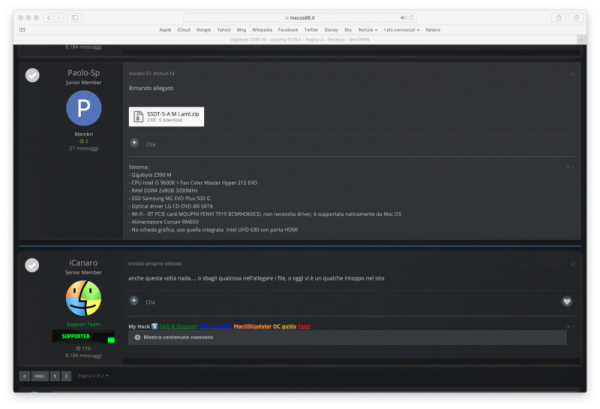

Paolo-Sp Posted November 20, 2019 Author Share Posted November 20, 2019 Rimando allegato SSDT-5-A M I.aml.zip Link to comment Share on other sites More sharing options...
Support Team iCanaro Posted November 20, 2019 Support Team Share Posted November 20, 2019 anche questa volta nada.... o sbagli qualcosa nell'allegare i file, o oggi vi è un qualche intoppo nel sito Link to comment Share on other sites More sharing options...
Paolo-Sp Posted November 20, 2019 Author Share Posted November 20, 2019 Cavolo ma io lo vedo allegato e riesco anche a scaricarlo ... guarda Link to comment Share on other sites More sharing options...
