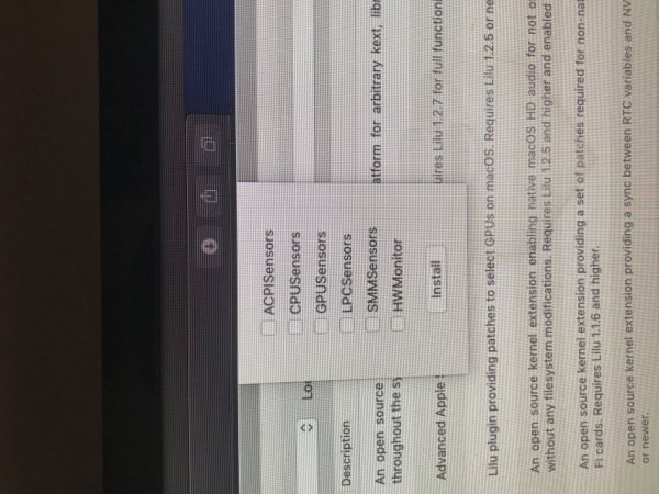

Supervisor. foskvs Posted November 2, 2019 Supervisor. Share Posted November 2, 2019 Togli i sensors. Le impostazioni del BIOS sono corrette? Link to comment Share on other sites More sharing options...
bossissimo Posted November 2, 2019 Author Share Posted November 2, 2019 sisi sono giuste, ora provo cosi va bene? Link to comment Share on other sites More sharing options...

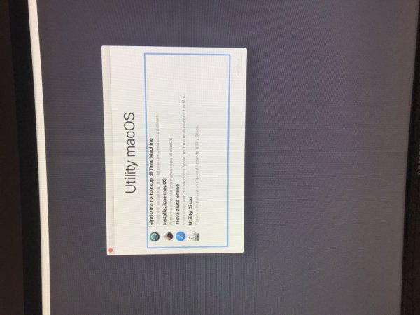

bossissimo Posted November 2, 2019 Author Share Posted November 2, 2019 sono riuscito a superare la prima parte, ora cosa faccio?? Link to comment Share on other sites More sharing options...
Administrators Gengik84 Posted November 2, 2019 Administrators Share Posted November 2, 2019 Come cosa fai? :D ora devi installare ;) seleziona la relativa voce e procedi, poi vai su utility disco e formatta a modo Link to comment Share on other sites More sharing options...
