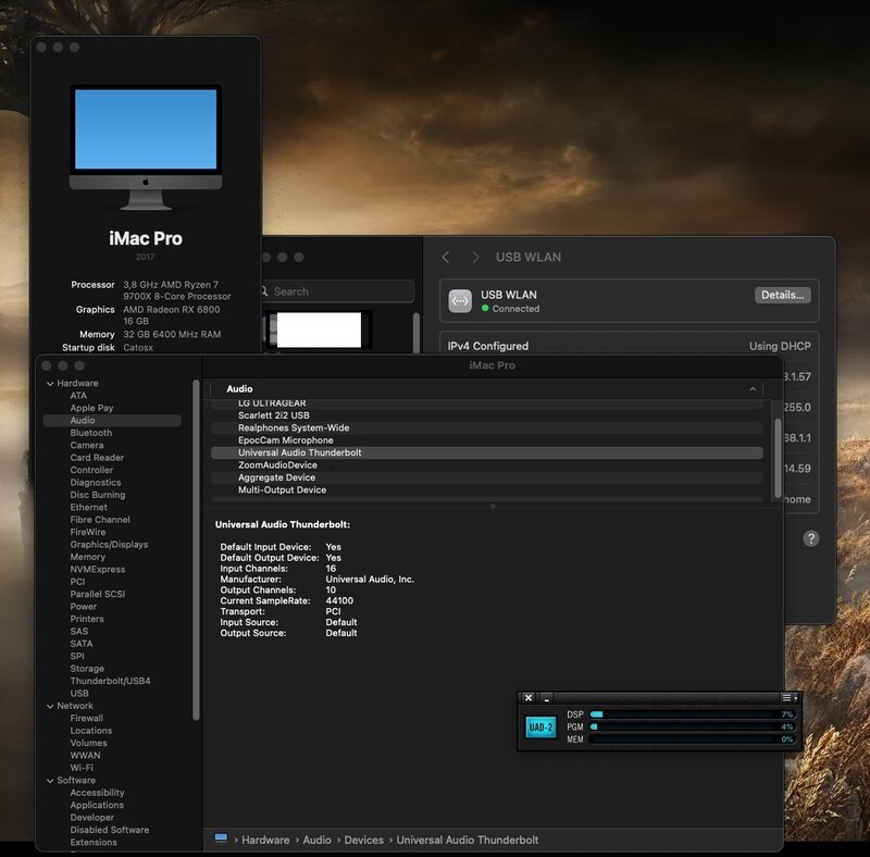

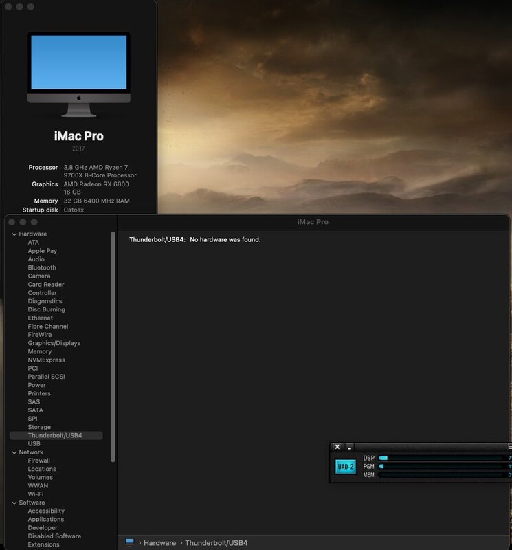

I've been wondering about the thunderbolt connection for a long time because I'm a musician.I follow CaseySJ in other forums and once he mentioned that if you connect your thunderbolt device to the pc in the open state when your computer is off, it will see it.It really works but the only problem is that it doesn't hot plug.So if you unplug and plug the usb c cable, it doesn't detect it. My problem right now is that it does not recognize realtek8125.I have a usb wifi card and it disconnects and connects in short intervals.I can recommend you to try your thunderbolt or usb 4 device.First create your map with USBToolBox and then add it to the efi
.Turn off the pc and turn your thunderbolt device on and boot the pc.It will most likely work.

I'm uploading some pictures for proof.

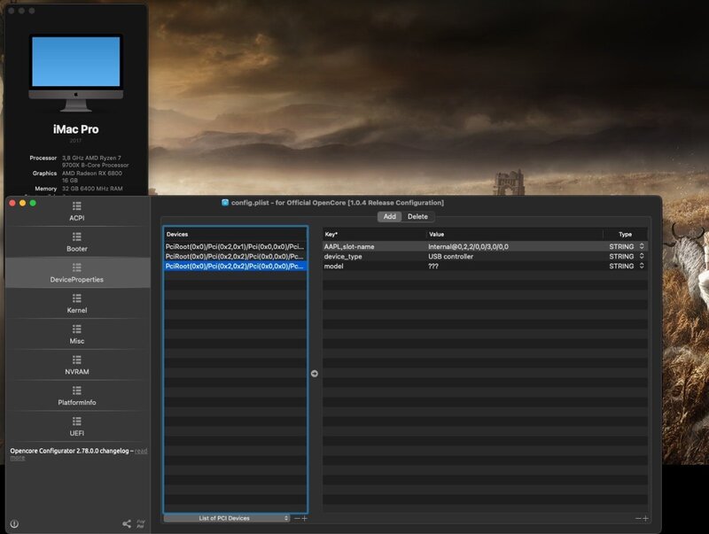

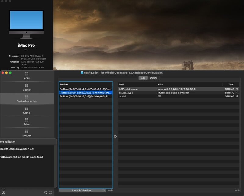

I added a few pci addresses from the opencore configurator and I'm not sure if that helped.
It works as seen in the pictures, now I have made an edit and I am trying to solve the usb disconnection problem.
usbc launchpad did not connect. it connected when I connected it from type a with the charging cable.i will try with other type c devices and write the results.as far as i understand the usb controller of type c is different.so you need to introduce it in kext or some other way.luckily it saw my sound card.
