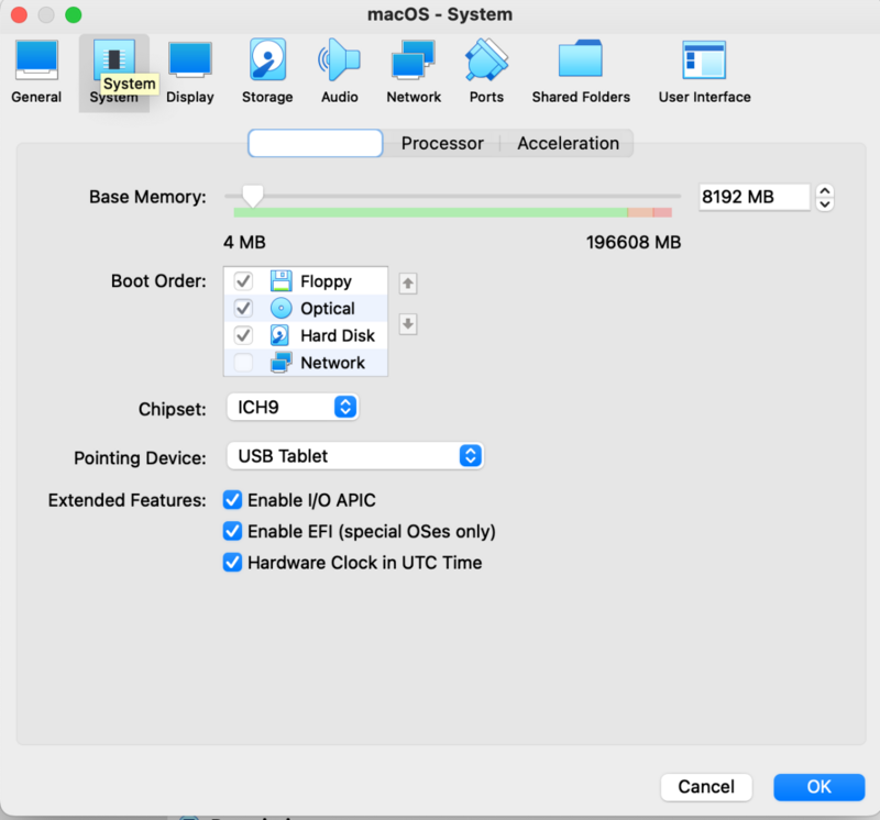

From Catalina on up an empty 16384 MB image must be created in disk utility. To get the Installers from High Sierra and up use our blazoned Runme_downloaderV4 which I attach.
The commands to create the bootable and writable installation media are respectively:
sudo /Applications/Install\ macOS\ High\ Sierra.app/Contents/Resources/createinstallmedia --volume /Volumes/HighSierra
sudo /Applications/Install\ macOS\ Mojave.app/Contents/Resources/createinstallmedia --volume /Volumes/Mojave
sudo /Applications/Install\ macOS\ Catalina.app/Contents/Resources/createinstallmedia --volume /Volumes/Catalina
sudo /Applications/Install\ macOS\ Big\ Sur.app/Contents/Resources/createinstallmedia --volume /Volumes/BigSur
sudo /Applications/Install\ macOS\ Monterey.app/Contents/Resources/createinstallmedia --volume /Volumes/Monterey

In particular, to allow, for example, the installation of Big Sur, assuming you have called the VM Mac, the commands to be given are:
/Applications/VirtualBox.app/Contents/macOS/VBoxManage modifyvm mac --cpuidset 00000001 000106e5 00100800 0098e3fd bfebfbff
/Applications/VirtualBox.app/Contents/macOS/VBoxManage modifyvm mac --cpu-profile "Intel Core i7-6700K"
/Applications/VirtualBox.app/Contents/macOS/VBoxManage setextradata mac "VBoxInternal/Devices/efi/0/Config/DmiSystemProduct" "iMac19,1"
/Applications/VirtualBox.app/Contents/macOS/VBoxManage setextradata mac "VBoxInternal/Devices/efi/0/Config/DmiSystemVersion" "1.0"
/Applications/VirtualBox.app/Contents/macOS/VBoxManage setextradata mac "VBoxInternal/Devices/smc/0/Config/DeviceKey" "ourhardworkbythesewordsguardedpleasedontsteal(c)AppleComputerInc"
/Applications/VirtualBox.app/Contents/macOS/VBoxManage setextradata mac "VBoxInternal/Devices/smc/0/Config/GetKeyFromRealSMC" 1
/Applications/VirtualBox.app/Contents/macOS/VBoxManage setextradata mac “VBoxInternal2/EfiGraphicsResolution 1280x800
/Applications/VirtualBox.app/Contents/macOS/VBoxManage setextradata mac "VBoxInternal/TM/TSCMode" "RealTSCOffset"
/Applications/VirtualBox.app/Contents/macOS/VBoxManage setextradata mac "VBoxInternal/Devices/efi/0/Config/DmiBoardProduct" "Mac-AA95B1DDAB278B95"

14. Finally, fine tune your guest OS for display USB pointing devices etc...
15. If you get problems running virtual box - quit Vbox completely (stop any guest VMs running first if you can) and then rerun it by running it from within Applications folder and not as an alias as sometimes aliases get corrupted or lose sight of the software.
16 I tried then resetting SIP to Enabled and disabling AMFIPass kext inside config plist Kernel section, reboot, resetting NVRAM and booting up to Sonoma but the Kernel errors reappeared and I found they were no longer 'Allowed' by the OS. Subsequently, virtual box guest VM's failed to start. 😞
17. So went back to partially Disabling SIP (csr-active-config = 03080000) but didn't require AMFIPass to ON now that Ive installed vBox.
More on this soon...

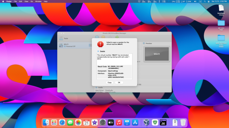

...but yet VirtualBox gives the standard "Result Code:  NS_ERROR_FAILURE (0x80004005)" error when I try to launch any guest.
I'm in the process of upgrading this box from Catalina to Ventura or Sonoma, and the broken Wi-Fi in Sonoma is making me strongly consider Ventura for now. However, I need Box so it's a conundrum. I really imagined that if it worked for the more locked down Sonoma it would be straightforward for Ventura.
Any thoughts? Thanks again; without this guide, I wouldn't even have the option for Sonoma.

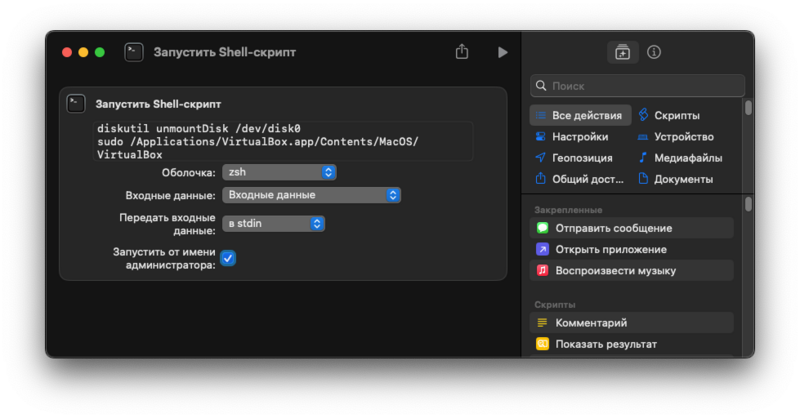

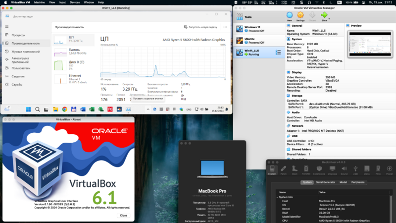

Hi! I have Legion 5-15ACH6A - Risen 5600H & Radeon RX 6600M in stock
Mac os Sequoia 15.2
VirtualBox 6.1.50
Virtual machines start perfectly in Normal Start (not in Headless start mode).
To run VirtualBox correctly on Sequoia, it is necessary to run the executable file via sudo:
sudo /Applications/VirtualBox.app/Contents/MacOS/VirtualBox
You can do this through the terminal or through the Command application in the form of a Shell script
or
result:

hi how to fix this error,virtualbox 6.1.5 ventura 13.7.1, i followed the instruction above,uninstall and reinstall 3 times but still no luck
It's broken in Ventura as far as we can tell. It works in Sonoma. If you absolutely must use Ventura, you can try starting the guests headless and then remote controlling them via SSH, VNC, RDP, etc, but you'd have to setup the the remote control services on the guest and the network bridging.
the same error using macos 15.1.1
