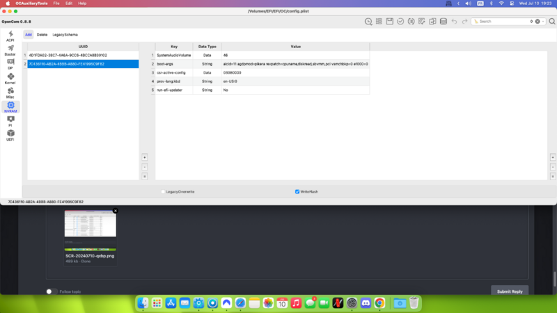

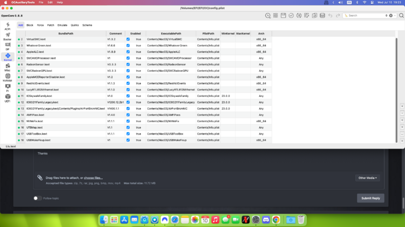

On macOS Sonoma 14.5, I've got an issue (a strange one) : Wifi is connected but without ethernet, I've got no wifi despite Airdrop working ! Do you have a workaround ?
I'm using OpenCore 1.0.0 with OpenCore Legacy Patcher (1.5) : the root patches worked fine, reset NVRAM couple of times...
Thanks

Post config file

Finally, the original BCM94360NG card was defective so... I'm not using Sonoma 14.5 anymore : I succeed in updating my Hackintosh to Sequoia Beta 3. I installed few minutes ago my MQUPIN Fenvi T919, patched it with OpenCore Legacy Patcher (a specific version - I can share the .zip) and everything works fine ! But I had to use the amfi=0x80 arguments because amfipass.kext (v. 1.4.0) prevented me to boot...

use amfi kext 1.4.1 and remove bootarg amfi=0x80 also see my git I'm use dw1820a and wifi work fine in beta3
https://github.com/Edwardwich/BCM-WIFI-Sequoia
