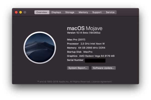

https://postimg.cc/image/rc9fm5vx7/">LINK_TEXT>
in processor tab you see unknown or your processors?
obviously if you have not modified it manually..as I do in my case
Processor is identified perfect!!
