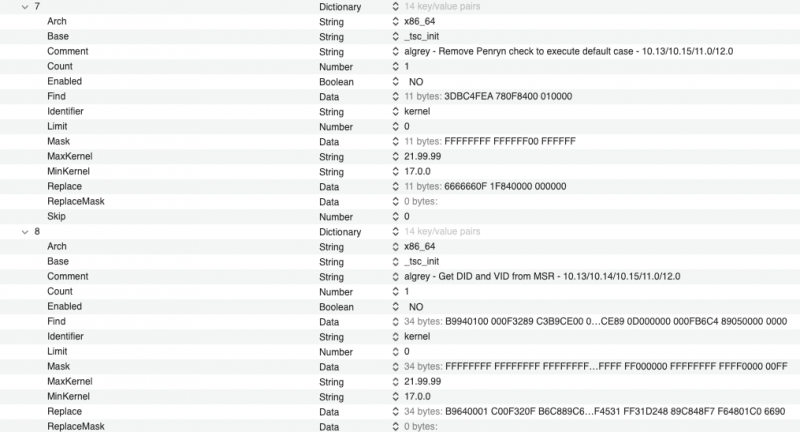

@jsl2000our problems in Clover Bootloader are here:
algrey - Remove Penryn check to execute default case - 10.13/10.15/11.0/12.0
algrey - tsc_init - grab DID and VID from MSR
to have a confirm you can use these two patches in Opencore (In a proper way ) and disable ProvideCurrentCPUquirk
You may have also need of CPU topology disable patch (I do not need of it)
you will see also in Opencore weird animation and double speed in some condition
SO our only chance is to convince Clover Devs to implement that opencore quirk!

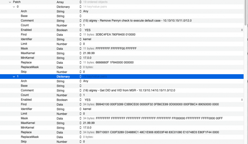

Thanks and do you mean I can disable ProvideCurrentCPUquirk and enable these two patches only ?
Or I need also disable CPU topology patch too ?
Unfortunately if I disable ProvideCurrentCPUquirk and enable these three patches it always freeze before +++++++++++++++++ appears.
Edited by jsl2000
Hi @jsl2000
cpu topology patch is not that one
you have to find the last published for opencore bootloader
it was simpler one like a replace with only a C3 as value
i didn’t need of it and I have not backupped it sorry
however this try is useful only to double check my discover
not useful to solve problems in clover.
if clover dev doesn’t implement well opencore way… we have to leave Clover🥲

Do you mean this one ?
Yes it should be it
in clover we use an older one because that one is not compatible with clover masking feature
It is sure that others two  patches create problems in clover and latest OS X
also in older OS X but  with less and clear damages

Unfortunately it still got the same freeze with this one patch plus the other two patches.
Is there specific order for these three kernel patches ?
I put them in the first three patches.
37 minutes ago, fabiosun said:
I have put the two I need in 7 and 8 position if you use entire sixteen Opencore patches
776480466_Screenshot2021-12-29at8_19_42AM.thumb.png.2c601d47108fef5fd3d33f464673d8dc.png
I do not need of topology patch both in clover and Opencore to boot
Put them as yours still got the same freeze at the same location.
Maybe due to the difference between our hardware (AMD Threadripper 3970x vs. Ryzen 1700X).
Edited by jsl2000

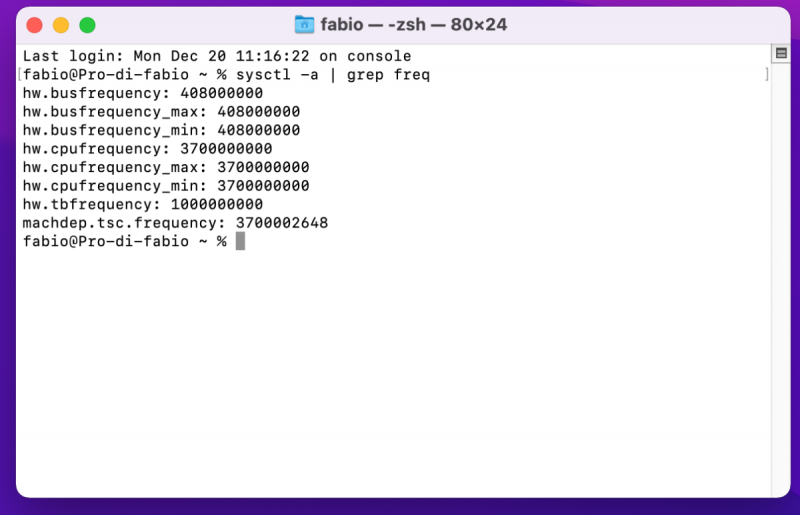

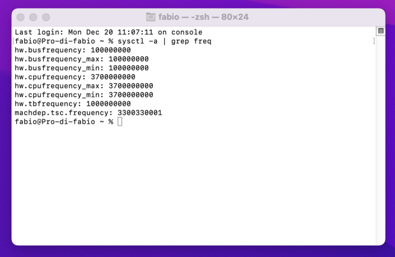

try to run this from terminal and see different without adding manually any frequency or tsc value:
sysctl -a | grep freq
and if you can compare it with both boot loader and also with old OSX
