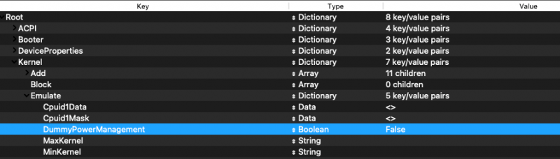

11 hours ago, Rox67er said:
Do you have DummyPowerManagement enabled? (Should be disabled)
592656842_Screenshot2021-10-14at19_48_19.thumb.png.98d5ea97fb776fedf3f8953b6c15a233.png
Mine is working just fine (Same motherboard)
While running Cinebench, I do run a low noise profile on my AIO so running a bit hot
Yes, DummyPowerManagement is disabled.

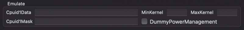

1 minute ago, fabiosun said:
great advice
I see many of you (ASRock creator users) use this quirk
But, if it not useful for you you should avoid that quirk
I've never had it enabled, should I try to enable it?
2 minutes ago, fabiosun said:
@23d1is that the previous you posted?
are you sure Do you have only a booting EFI in your system ?
I have downloaded again it and it is on true
If you used @DriftwoodEFI he has tha quirk on /yes/true
Yes, I just mounted the EFI to check and grab that screenshot. Could it be my ProperTree not showing the right values? Everything else seems to be in order...
Edited by 23d1
3 minutes ago, fabiosun said:
check if that you posted here (quoted one before) give the same
if so..you have a problem 😛

and this is previous yours with correct value for dummy
I do not know if that quirk is useful or not for you because to some users solve some freeze after few minutes of OS usage
