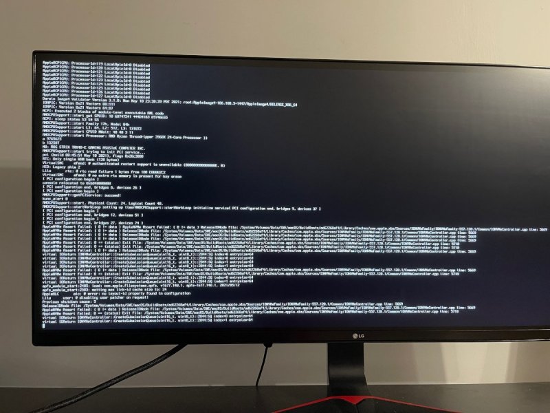

been trying form 20 hours to get this to work 😞 came across this thread tried your latest config file with platform info added but i get this error attached.
Im not sure wht to do now 😞
i have attached my EFI folder any help would be really appreciated.
thanks a ton in advance
EFI.zipFetching info...

I managed to get past this by getting some efi's form the openc ore folder but some reason my install keeps booot looping and doesn't complete installation.

Audio driver missing in your driver folder

Secure boot model try default then do a little further research  the number above j160 is for MacPro 7.1
