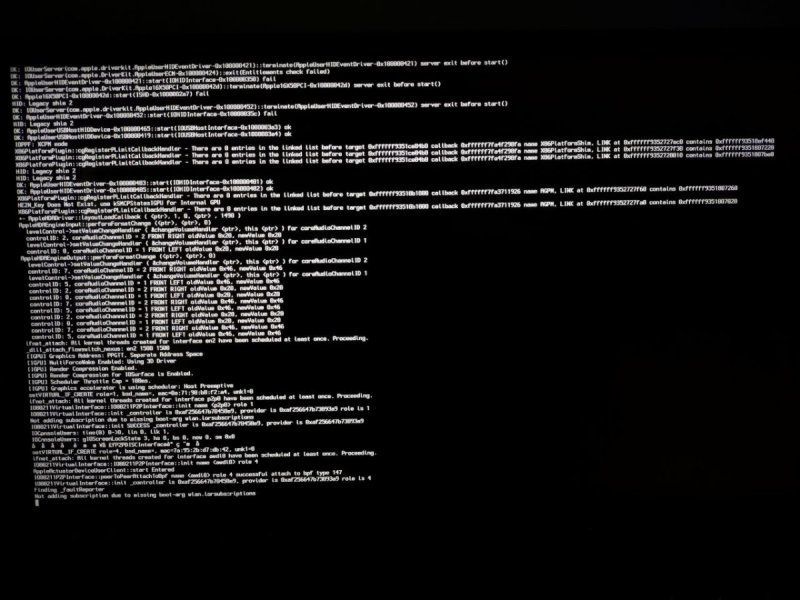

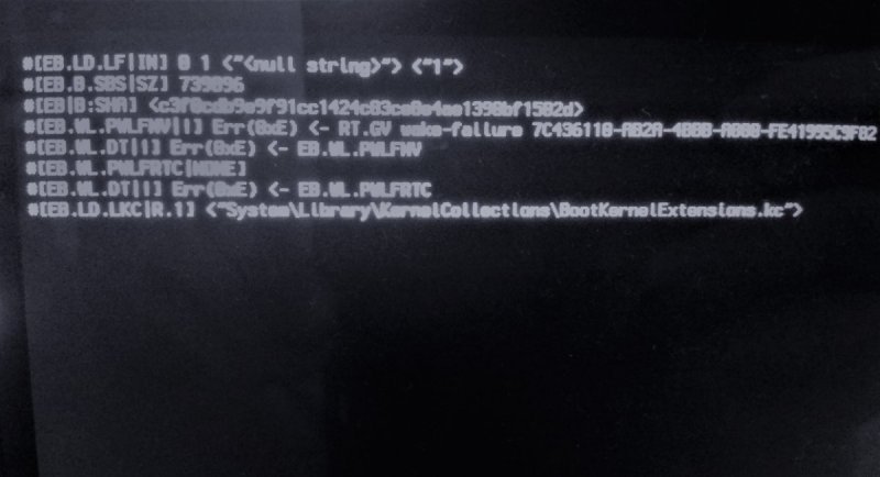

Ciao, qualcuno può aiutarmi? Non sto andando oltre qui.
@Lorys89 forse hai un'idea? Ho preso l'EFI da @richibrics
00:000 00:000 AAPL: #[EB.H.IS|!] Err(0xE) <- RT.GV boot-signature 7C436110-AB2A-4BBB-A880-FE41995C9F82
00:044 00:044 AAPL: #[EB.H.IS|!] Err(0xE) <- RT.GV boot-image-key 7C436110-AB2A-4BBB-A880-FE41995C9F82
00:086 00:041 AAPL: #[EB|H:IS] 0
00:127 00:041 AAPL: #[EB|LOG:INIT] 2021-09-05T13:41:52
00:169 00:041 AAPL: #[EB|VERSION] <"bootbase.efi 495.140.2~3 (Official), built 2021-06-21T19:20:21-0700">
00:210 00:041 AAPL: #[EB|BUILD] <"BUILD-INFO[306]:{"DisplayName":"bootbase.efi","DisplayVersion":"495.140.2~3","RecordUuid":"D1225010-D2B5-46DE-95DA-C2176313E127","BuildTime":"2021-06-21T19:20:21-0700","ProjectName":"efiboot","ProductName":"bootbase.efi","SourceVersion":"495.140.2","BuildVersion":"3","BuildConfiguration":"Release","BuildType":"Official"}">
00:255 00:045 AAPL: #[EB.CFG.DEV|!] Err(0xE) <- RT.GV booter-strict-xmlparser 7C436110-AB2A-4BBB-A880-FE41995C9F82
00:297 00:041 AAPL: #[EB|CFG:DEV] r5 0x0 0x0
00:338 00:041 AAPL: #[EB|H:IS] 0
00:380 00:041 AAPL: #[EB|WL:MODE] 0
00:421 00:041 AAPL: #[EB|CFG:ARG] boot-save-log 0x0000000000000002 (0x0000000000000002 < 0xFFFFFFFFFFFFFFFF) default
00:463 00:041 AAPL: #[EB|CFG:ARG] wake-save-log 0x0000000000000002 (0x0000000000000002 < 0x0000000000000002) default
01:147 00:684 AAPL: #[EB|CFG:ARG] console       0x0000000000000001 (0x0000000000000001 < 0x0000000000000001) default
01:203 00:056 AAPL: #[EB|CFG:ARG] serial        0x0000000000000001 (0x0000000000000001 < 0x0000000000000000) default
01:245 00:041 AAPL: #[EB|CFG:ARG] embed-log-dt  0x0000000000000000 (0x0000000000000000 < 0x0000000000000000) default
01:286 00:041 AAPL: #[EB|CFG:ARG] timestamps    0x0000000000000000 (0x0000000000000000 < 0xFFFFFFFFFFFFFFFF) default
01:327 00:041 AAPL: #[EB|CFG:ARG] log-level     0x0000000000000001 (0x0000000000000001 & 0x0000000000000021) default
01:369 00:041 AAPL: #[EB|CFG:ARG] breakpoint    0x0000000000000000 (0x0000000000000000 & 0x0000000000000000) default
01:410 00:041 AAPL: #[EB|CFG:ARG] kc-read-size  0x0000000000100000 (0x0000000000100000 < 0xFFFFFFFFFFFFFFFF) default
01:452 00:041 AAPL: #[EB|H:IS] 0
01:494 00:041 AAPL: #[EB|WL] 0 0 0x01 0x01   0 0x00
01:535 00:041 AAPL: #[EB|BRD:NV] Mac-E7203C0F68AA0004
01:577 00:041 AAPL: #[EB|WL] 0 0 0x01 0x01   2 0x00
01:618 00:041 AAPL: #[EB.BST.IDT|+]
01:660 00:041 AAPL: #[EB.BST.IDT|-]
01:702 00:041 AAPL: #[EB|WL] 0 0 0x01 0x01   3 0x00
01:743 00:041 AAPL: #[EB|WL] 0 0 0x01 0x01   4 0x00
01:785 00:041 AAPL: #[EB|BRD:NV] Mac-E7203C0F68AA0004
01:826 00:041 AAPL: #[EB|WL] 0 0 0x01 0x01   5 0x00
02:508 00:682 AAPL: #[EB.H.CHK|BM] 0x0000000000000000
02:550 00:041 AAPL: #[EB.H.LV|!] Err(0xE) <- RT.GV boot-signature 7C436110-AB2A-4BBB-A880-FE41995C9F82
02:591 00:041 AAPL: #[EB|WL] 0 0 0x01 0x01  23 0x0E
02:633 00:041 AAPL: #[EB.H.LV|!] Err(0xE) <- RT.GV boot-image-key 7C436110-AB2A-4BBB-A880-FE41995C9F82
02:686 00:053 AAPL: #[EB|WL] 0 0 0x01 0x01  24 0x0E
02:728 00:041 AAPL: #[EB.H.LV|!] Err(0xE) <- RT.GV boot-image 7C436110-AB2A-4BBB-A880-FE41995C9F82
02:769 00:041 AAPL: #[EB.H.LV|!] Err(0xE) <- RT.SV- boot-signature 7C436110-AB2A-4BBB-A880-FE41995C9F82
02:811 00:041 AAPL: #[EB.H.LV|!] Err(0xE) <- RT.SV- boot-image-key 7C436110-AB2A-4BBB-A880-FE41995C9F82
02:852 00:041 AAPL: #[EB.H.LV|!] Err(0xE) <- RT.SV- boot-image 7C436110-AB2A-4BBB-A880-FE41995C9F82
03:533 00:680 AAPL: #[EB|H:NOT]
03:575 00:041 AAPL: #[EB|SB:P] 0x0
03:616 00:041 AAPL: #[EB|LIMG:DP] VenMedia(957932CC-7E8E-433B-8F41-D391EA3C10F8)/MemMap(10:100000000-100001000)/DMG_0000000027D7D1B5.dmg/VenMedia(004B07E8-0B9C-427E-B0D4-A466E6E57A62)/HD(Part1,Sig65B6322A-16F6-4416-B540-E09404247E1D)
03:658 00:041 AAPL: #[EB|LIMG:FP] \System\Library\CoreServices\boot.efi
03:699 00:041 AAPL: #[EB|LIMG:OPT]
03:741 00:041 AAPL: #[EB.B.OBV|BM:+DMG]
03:782 00:041 AAPL: #[EB.B.OBV|BM:+ROS]
03:830 00:047 AAPL: #[EB|RPS] 0 0 0
03:872 00:041 AAPL: #[EB.OPT.LXF|F] <"\\System\\Library\\CoreServices\\com.apple.Boot.plist">
03:914 00:041 AAPL: #[EB.LD.LF|IN] 0 1 <"\\System\\Library\\CoreServices\\com.apple.Boot.plist"> <"0">
03:955 00:041 AAPL: #[EB.LD.OFS|OPEN!] Err(0xE) <"\\System\\Library\\CoreServices\\com.apple.Boot.plist">
03:997 00:041 AAPL: #[EB.OPT.LXF|LF!] Err(0xE)
04:038 00:041 AAPL: #[EB.OPT.LXF|F] <"Library\\Preferences\\SystemConfiguration\\com.apple.Boot.plist">
04:080 00:041 AAPL: #[EB.LD.LF|IN] 0 1 <"Library\\Preferences\\SystemConfiguration\\com.apple.Boot.plist"> <"0">
04:153 00:073 AAPL: #[EB|KF] <"">
04:206 00:053 AAPL: #[EB|MBA:CL] <"">
04:248 00:041 AAPL: #[EB|MBA:NV] <"-v -vi2c-force-polling">
04:289 00:041 AAPL: #[EB|MBA:KF] <"">
04:331 00:041 AAPL: #[EB|MBA:OUT] <"-v -vi2c-force-polling">
04:373 00:042 AAPL: #[EB|LOG:VERBOSE] 2021-09-05T13:41:56
04:414 00:041 AAPL: #[EB|OPT:BM] 0x821002
04:456 00:041 AAPL: #[EB.OPT.LXF|F] <"\\System\\Library\\CoreServices\\PlatformSupport.plist">
04:497 00:041 AAPL: #[EB.LD.LF|IN] 0 1 <"\\System\\Library\\CoreServices\\PlatformSupport.plist"> <"0">
04:554 00:056 AAPL: #[EB|B:VAw]
04:595 00:041 AAPL: #[EB.B.MN|BM:ROS]
04:637 00:041 AAPL: #[EB|WL] 0 0 0x01 0x01  19 0x0E
05:316 00:679 AAPL: #[EB.CS.CSKSD|+]
05:358 00:041 AAPL: #[EB.G.CS|-?] Ok(0)
05:400 00:041 AAPL: #[EB.LD.LF|IN] 0 1 <"<null string>"> <"1">
06:891 01:491 AAPL: #[EB.B.SBS|SZ] 739896
06:942 00:050 AAPL: #[EB|B:SHA] <c3f0cdb9e9f91cc1424c83ce8e4ae1390bf1502d>
06:984 00:042 AAPL: #[EB.WL.PWLFNV|!] Err(0xE) <- RT.GV wake-failure 7C436110-AB2A-4BBB-A880-FE41995C9F82
07:026 00:042 AAPL: #[EB.WL.DT|!] Err(0xE) <- EB.WL.PWLFNV
07:068 00:041 AAPL: #[EB.WL.PWLFRTC|NONE]
07:109 00:041 AAPL: #[EB.WL.DT|!] Err(0xE) <- EB.WL.PWLFRTC
07:163 00:053 AAPL: #[EB.LD.LKC|R.1] <"System\Library\KernelCollections\BootKernelExtensions.kc">
