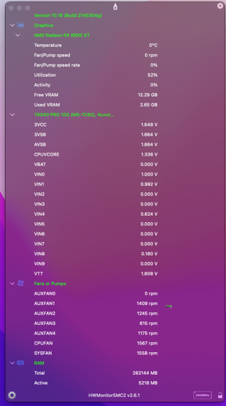

21 minutes ago, Arrakis said:
@fabiosun Could you explain your last two posts? , Do you work on temperatures?
Ciao @Arrakis I am trying kexts and apps
I can see utilisation of gpu (%) with HWMonitorSMC2
I can see Die Temp with HWMonitorSMC (only till Big Sur )
For now no RPM on FAN
We have to find right mix to have all working (trying fakeSMC.kext and radeon plugin
fabio@Mac-Pro ~ % kextstat | grep -v com.apple
Executing: /usr/bin/kmutil showloaded
No variant specified, falling back to release
Index Refs Address            Size       Wired      Name (Version) UUID <Linked Against>
   19    1 0                  0x18000    0x18000    org.netkas.FakeSMC (3.5.3) 503675DF-E091-38F2-AE0C-5A1F93D84E15 <15 9 7 6 3>
   20    0 0                  0x10000    0x10000    org.slice.RadeonMonitor (1.3.5) E2EAA0B3-8A35-387B-A86C-6E75659CFD8F <19 16 9 6 3>
   53    3 0                  0x2e000    0x2e000    as.vit9696.Lilu (1.5.5) 7B68D081-1C6B-3597-9455-F1803E31B48A <9 7 6 3 2 1>
   54    0 0                  0x181000   0x181000   as.vit9696.AppleALC (1.6.3) 571451FE-241B-3205-B100-C1E0E86F983A <53 16 9 7 6 3 2 1>
   55    0 0                  0xc000     0xc000     as.vit9696.RestrictEvents (1.0.3) CB8A2AD8-3AE2-3DF5-8398-BEB24C012480 <53 9 7 6 3 2 1>
   56    0 0                  0x20000    0x20000    wtf.spinach.AMDRyzenCPUPowerManagement (0.7) 10AE6854-47D8-3FE6-B1D3-66937EF615EF <53 16 12 9 7 6 3 2 1>
fabio@Mac-Pro ~ %
