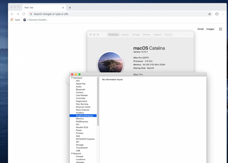

I managed to install Catalina and wifi and ethernet is working as well as audio!
However , the system is very laggish and slow and the graphics card is not recognized at all in System Report.
Are SSTDS responsible for that? I  will attach a video of how it reacts!
Thank you!

11 minutes ago, fabiosun said:
you have to cover only your serial number on about my Mac..and let see gpu memory or name...
it seems your GPU is not active and it seems you are in vesa mode
It doesnt show any Graphics card information there! Nothing at all!
How do i get out of vesa mode?
Surprisingly wifi , ethernet , imessage , audio works but everything is very laggy and slow
Edited by info
which EFI have you used?
if we miss this we can't say anything more 😛
I dont remember the User that posted this but I have attached the latest working one i have. I made some adjustments to remove unwanted stuff.
It also takes a while to boot up! Not too long but quite slow
