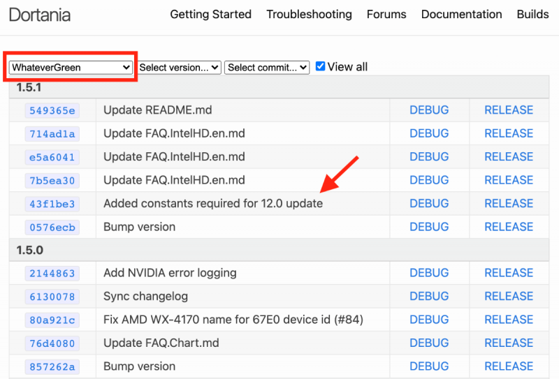

Moderators iGPU Posted June 8, 2021 Moderators Share Posted June 8, 2021 (edited) I've referred to this site before, but go here and use the pop-up in upper left corner to select the various kexts. Download the latest release versions that will now support macOS 12 without having to use various boot-args. These were all updated by PMHeart. Update: PMHeart now suggesting boot-args (-wegbeta -lilubetaall) are still needed and may not be fixed until the 2021-July release of Monterey. Edited June 8, 2021 by iGPU Link to comment Share on other sites More sharing options...

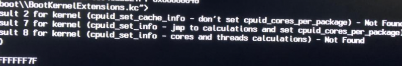

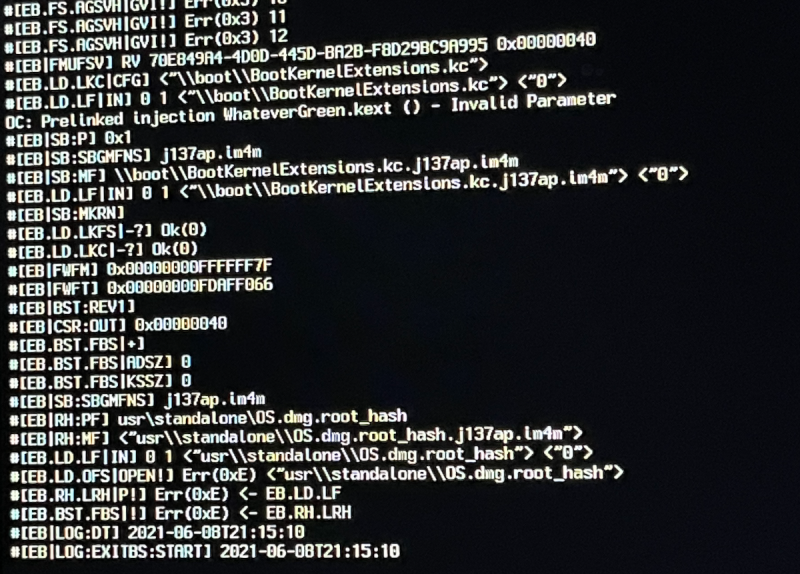

valmeida Posted June 8, 2021 Share Posted June 8, 2021 9 hours ago, iGPU said: I've referred to this site before, but go here and use the pop-up in upper left corner to select the various kexts. Download the latest release versions that will now support macOS 12 without having to use various boot-args. These were all updated by PMHeart. Update: PMHeart now suggesting boot-args (-wegbeta -lilubetaall) are still needed and may not be fixed until the 2021-July release of Monterey. I have updated all my kext including Lilu and WEG added boot-args -wegbeta -lilubetaall and I get stuck in this point of the boot process. Link to comment Share on other sites More sharing options...

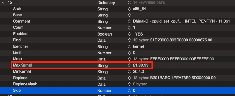

Moderators iGPU Posted June 9, 2021 Moderators Share Posted June 9, 2021 5 hours ago, valmeida said: I have updated all my kext including Lilu and WEG added boot-args -wegbeta -lilubetaall and I get stuck in this point of the boot process. Yes, me too. It is related to incorrect Kernel/Patches. We must wait until these are sorted out (I don't know how to create them). But, remember to adjust Patches and Kexts to change any MaxKernel 20.99.99 values to 21.99.99 (20 = Big Sur; 21 = Monterey). Otherwise, nothing will load for Monterey! Link to comment Share on other sites More sharing options...
Supervisor fabiosun Posted June 9, 2021 Author Supervisor Share Posted June 9, 2021 @valmeidayou have also a weg boot parameters problem from your verbose For patches we have to wait as usual I think kernel locations of the older ones are not public... we miss a man like pikeralpha in these days 🙂 1 2 Link to comment Share on other sites More sharing options...

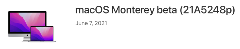

Moderators iGPU Posted June 11, 2021 Moderators Share Posted June 11, 2021 Soon. See this post from today. 1 1 1 Link to comment Share on other sites More sharing options...

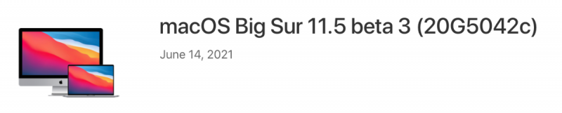

Ploddles Posted June 14, 2021 Share Posted June 14, 2021 Link to comment Share on other sites More sharing options...
