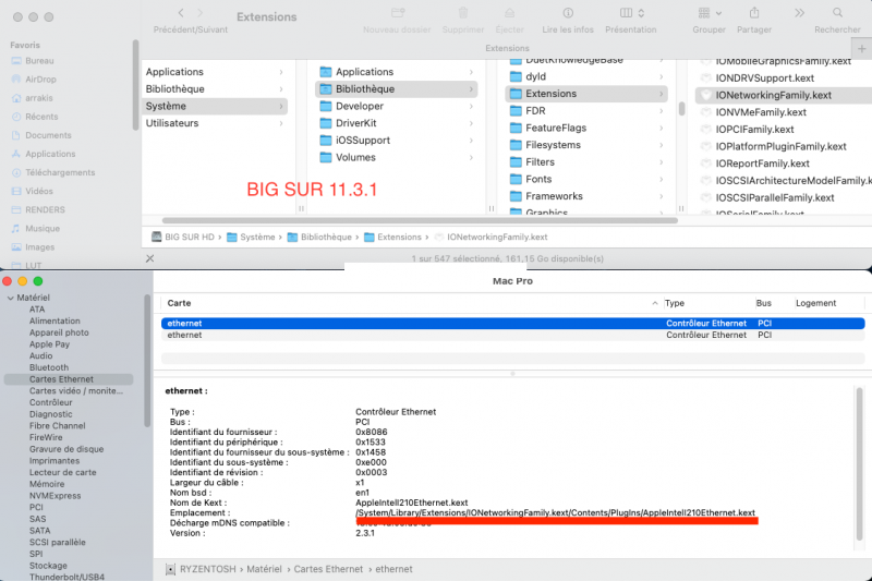

I did the test to remove the Titan Ridge card and my problem is still there. We can therefore definitively exclude a possible problem related to the thunderbolt.
What tickles me from the start is that the motherboard ethernet module is not recognized under 11.4 while under 10.15 to 11.3.1 it has always been recognized.
For what reason under 11.4. beta3 the system points to the wrong folder for the ethernet module extension ?
Why ?
Is there a way in Open-Core to assign the correct folder ?
I have checked in IONetworkingfamily.kext and its plugins. Nothing has changed.
699080106_Capturedecran2021-05-12a15_27_12.thumb.png.2f9355755df431c48dfeaf5e8718ee72.png214242624_Capturedecran2021-05-12a15_22_34.thumb.png.8148ac3fb2321653050f3c78d42f20e9.png
Why ?

I looked at the LAN section of your IORE file (BTW, the TB  section is PERFECT!):
Was the IORE file without a LAN kext? It looks good as is (and maybe needs a DeviceProperties injection).
If a kext was used and the LAN was not working, then maybe try the one I've attached.
Also, can you upload the txt or plist file from Hackintool for the PCI section for your mobo? If you do, I can work up a DeviceProperties injection for you to maybe enable better LAN functionality.

7 hours ago, Arrakis said:
@iGPU
Here is the .txt file of the PCI implementation. There is no improvement under Big Sur 11.4. beta 3 with your SmallTreeIntel82576-I211.kext for the ethernet module.
I attach the config.plist of my current setup which works fine on Big Sur 11.3.1.
PCI DEVICES ARRAKIS.zip 13.72 kB · 1 download config arrakis.plist.zip 6.83 kB · 0 downloads
Try adding the code below into your Device/Properties section to see if that helps. (You should try this ± SmallTreeIntel82576 kext.)
From the pcidevices list, I see that you have IOMMU enabled. This is required for VM, but not bare metal. I keep it disabled. I don't know if this would have any influence on LAN behavior; I've never checked. Disabling it might affect MMIOWhitelist. Also in BIOS, do you have Wake on LAN disabled?
            <key>PciRoot(0x2)/Pci(0x1,0x1)/Pci(0x0,0x0)/Pci(0x3,0x0)/Pci(0x0,0x0)</key>
			<dict>
				<key>AAPL,slot-name</key>
				<string>Built in</string>
				<key>built-in</key>
				<data>
				AA==
				</data>
				<key>device_type</key>
				<string>Ethernet Controller</string>
				<key>model</key>
				<string>Intel I210 Gigabit Network Connection</string>
				<key>name</key>
				<string>Intel I210 Ethernet</string>
			</dict>
			<key>PciRoot(0x2)/Pci(0x1,0x1)/Pci(0x0,0x0)/Pci(0x5,0x0)/Pci(0x0,0x0)</key>
			<dict>
				<key>built-in</key>
				<data>
				AA==
				</data>
				<key>model</key>
				<key>name</key>
			</dict>
