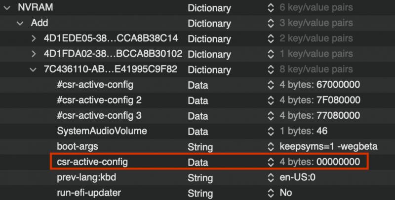

Im having an issue downloading and installing 11.2  RC . I have access to  Apple Developer Program but it  tells me my Mac is up to date even after I enrolled in e the Apple Developer Seed Program . I was able to update my MacBook Pro to 11.2 RC just fine. Im  also trying to find a way to download the update using my MacBook into a usb and then run form the USB but  don't think there is a link .
I've found that updates don't install properly unless car-active-config is set to 00000000 as shown below. After changing, you must re-boot, then re-try the OS update.
(I keep a set of alternative settings inactivated with a "#" symbol shown as the top of this section.)

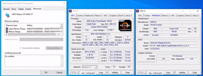

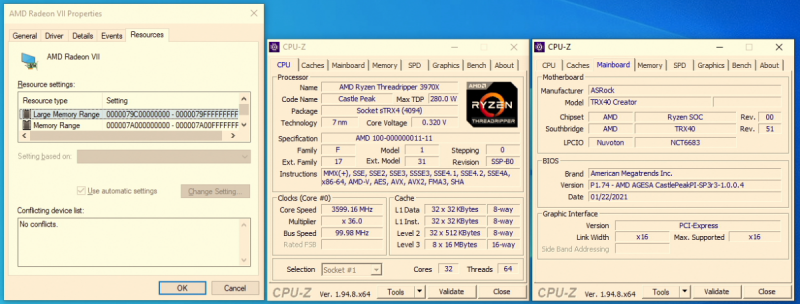

TRX40 Creator can enable resizable BAR with BIOS P1.74. Both RX6000 series and Radeon VII can turn on “Large memory range” normally. Linux and Windows currently work, Mac OSX currently doesn't support this feature but maybe in a future update/Opencore hack?!
6800XT & RADEON VII BAR test results in Windows:
I am awaiting info from Asrock support regarding how MMIO will be affected. In the meantime, Asrock said, "In the games we tested, it seem that resizable BAR had a less affect to performance".
Edited by Driftwood
It worked thanks.
