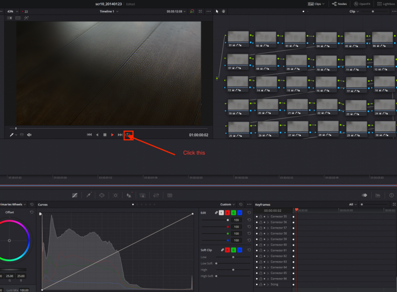

I am starting to wonder if there is any defect with the Radeon 6900XT I got related to the failure to play the file in DaVinci resolve project you shared. I installed Resolve on Fedora Linux to rule out some Windows VM driver issue, and I have the same problem. How do I troubleshoot this Resolve? When I relink or replace the file, I get a blank unplayable track.
Btw I installed Resolve 17 beta. Could that be the problem? Although the more likely explanation is user error / inexperience w Resolve.

I still have problems. I didn't try waiting for long time yet. Weird thing is that the 1st time I ran it, I saw the video but didn't capture the frame rate. I still wonder what the issue is. May retry tonight by reinstalling resolve
@meina222  When I relink the media file it doesn't immediately show in the preview window(s). I seem to have to flick between the Edit and Colour work spaces, or whatever they are called in Resolve - the tabs at the bottom of app, a few times and eventually it appears. It does seem strange behaviour but it is the same in 16 & 17.
Maybe you could temporarily load Teamviewer, or something similar, and let @fabiosun remote control your machine. Just a suggestion but entirely up to both of you.
@meina222
To wait for the images to be displayed in the viewer or the timeline in the grading studio, it is because of OpenCL, we have to wait. It can be long,
I have the same problem. (As soon as you're metal, there isn't this display problem.)
In fact, on Windows 10 is the same but the display time is much faster.
