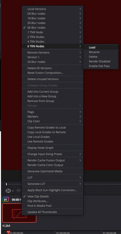

then in color tab you have also to choose number of nodes
usually 6 TRN nodes or 66 Noise nodes and press play to see framerate

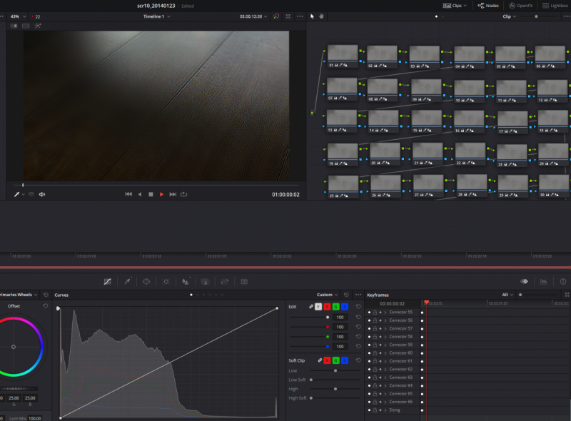

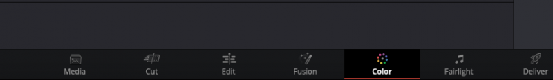

This is with 66 Nodes. The top images is when I have Edit selected in the bottom tab bar (24 frames), the second image when I have Colour selected in the bottom tab bar (20 - 22 frames).
How does that compare?
It compares pretty well if you don't have unlocked playback frame rate
a green 24 frames means your gpu play well during the test, in my case on my Vega 64 I have 14 fps during 66 node test
About 20 during 6 TRN nodes test
with my old Titan Xp I had about 20 on 66 nodes test and I think about 30/31 on 6 TRN nodes test (I do not remember well
2 minutes ago, Ploddles said:
Still the same, flipping between 21 and 22 (OpenCL).
uhm..if so this confirms that new AMD GPU don't play well with OpenCL...
to be clear it seems they are worst also of a cheaper RTX 3070 card..and for me this is unbelievable 😞
I have to hope in a better driver or in a Metal OSX support...but these numbers are worst than Radeon VII previous top of the line AMD GPU

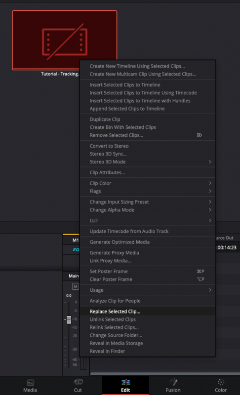

5 minutes ago, fabiosun said:
@meina222click on project and open it
then from the edit page click on red clip icon (missing link) right clip replace file
search on your drive trackingxxxx.mov file and choose it
then move to color page and press space

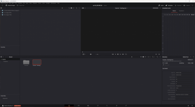

When I did this for the first time earlier, when you try to relink it just browse to where the .mov file is located, you don't actually see it listed. I thought I was doing something wrong but you aren't.  Just select open and it will take a few seconds before you see the clip in Resolve.
Edited by Ploddles
Do you mean "Tutorial - Tracking" MOV file? I tried. Nothing. The weird thing is that I was able to see the frames about an hour ago but had to head out and when I came back I restarted and it was blank.
Stepping aside for 15 min ... Will try again in a bit.
