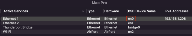

318057541_ScreenShot2021-10-06at8_27_53PM.thumb.png.43048bdb3c9a52f97025f587223b9543.png
How to re-set to "en0" has been discussed before, but in case you've forgotten:
Re-set “en0” ethernet configuration from Terminal, then re-boot computer:
sudo rm /Library/Preferences/SystemConfiguration/NetworkInterfaces.plist

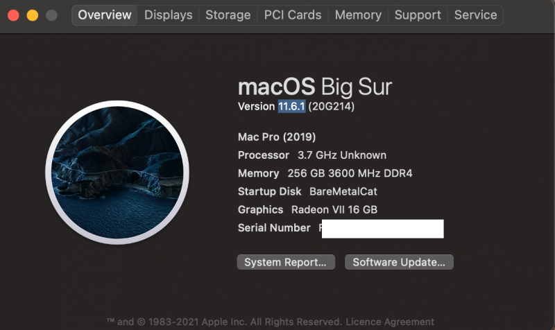

On 10/7/2021 at 1:46 PM, Driftwood said:
Big Sur Updated: 11.6.1 easily with latest OC 0.74 (SecureBootMethod=Default) As simply as Monterey Beta 9. Thats all.
1909394479_Screenshot2021-10-07at21_42_55.thumb.png.94cfcabbe0f3032f48571f78891f5d4a.png
