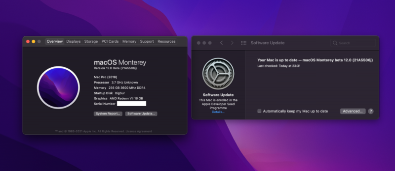

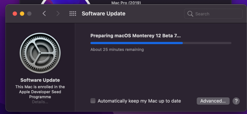

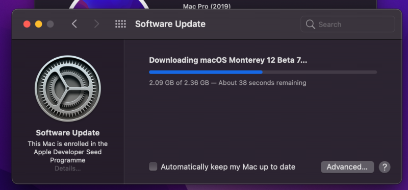

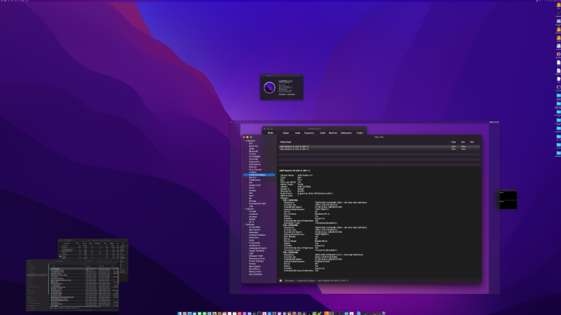

Big Sur 11.5.2 straight to Monterey Beta 12.06 and then onto beta 7. Strangely I could only download the installer with that cruddy old EFI with all the patches on (no j160 was used!) - Reduced patch EFI just wouldn't do it. And then switched half way thru install (2nd reboot) to reduced patch EFI. And we're in! Now lets do 7.

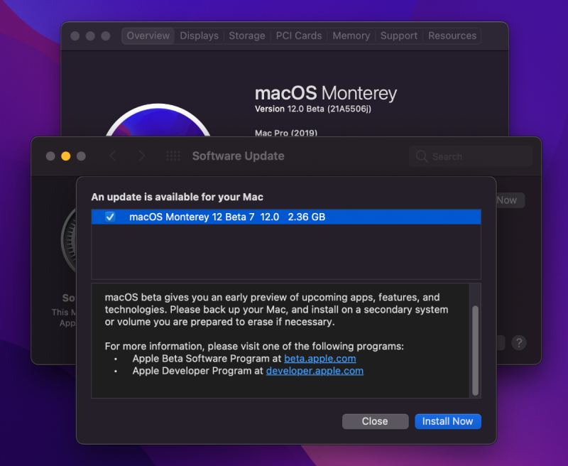

Now to do the beta 7 update you have to change SMBIOS to iMacPro17,1  - reboot - get the update.  download,
1595952559_Screenshot2021-09-21at23_59_21.thumb.png.f5340f3bde5c45b5e2523b92208a0bb2.png
Install (during install some users have managed to change SMBIOS back to = MacPro7,1 and get the install working), or, after first reboot switch to your OC usb stick with 7,1 SMBIOS on (which is what I did in the end).
Anyways, here's the complete process I did:-
1/ Change config to iMacPro17,1
Now let it download... you shouldn't need to set j160 in SecureBootModel to download.
599658563_Screenshot2021-09-22at00_04_39.thumb.png.e890717f643a522a1916edf67d65b6f2.png
2/ Let it continue install...
1427324706_Screenshot2021-09-22at00_05_33.thumb.png.c686698d45cb142f45e6e37f951ad484.png
3/ It will reboot to black install gauge...
4/ Next reboot (if you can, switch configs to your 7,1 SMBIOS on a separate USB stick ) or let it go on to 17,1 install.

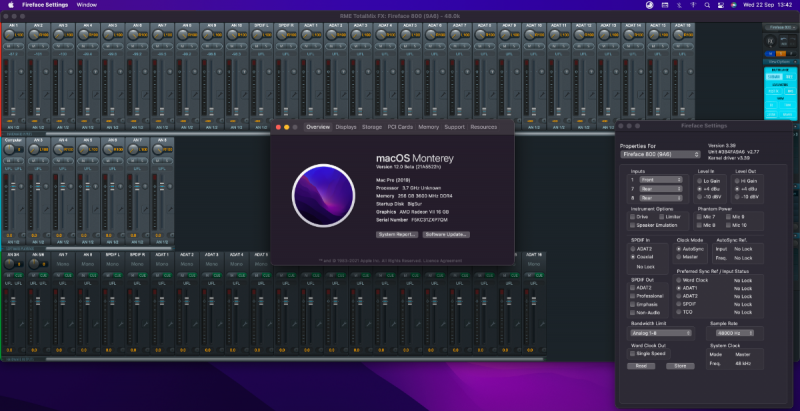

5/. As soon as your in Beta 7, ensure SMBIOS is back to MacPro7,1 settings, reboot to check. Update NVRAM.
2063391475_Monterey12beta7Threadripper3970x.thumb.png.0047cd00c3d597582beb2f12a098f009.png
We're in!

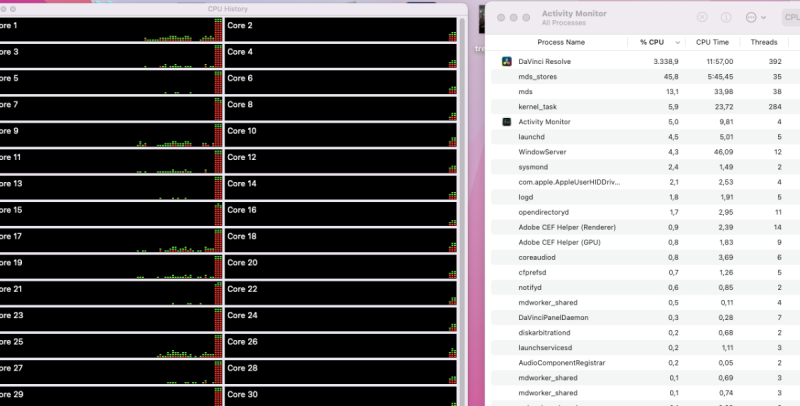

Also question for everybody, if running Quicktime movies/Apple TV / or FCPX (like here) how much of your CPU% in VTDecoderXPCService is being used? Over 300% playback and sometimes unto 1000% for FCPX encodes? I would be interested in hearing results.
Actually Davinci shows less than half the cpu& time over FCPX doing the same video.
181703970_Screenshot2021-09-22at14_11_05.thumb.png.7457567f1e0bf0bb8ad6ecc325a2b7dd.png
Edited by Driftwood

On 9/22/2021 at 4:18 PM, fabiosun said:
632977976_Screenshot2021-09-22at16_17_03.thumb.png.83aff82e6785947c286a79c08450ed8a.png
first one a simple timeline play
Second one a complex SFX export I Apple Pro Res 422 (4k)
Yeah 422 10-bit encodes will smack up the CPU%.

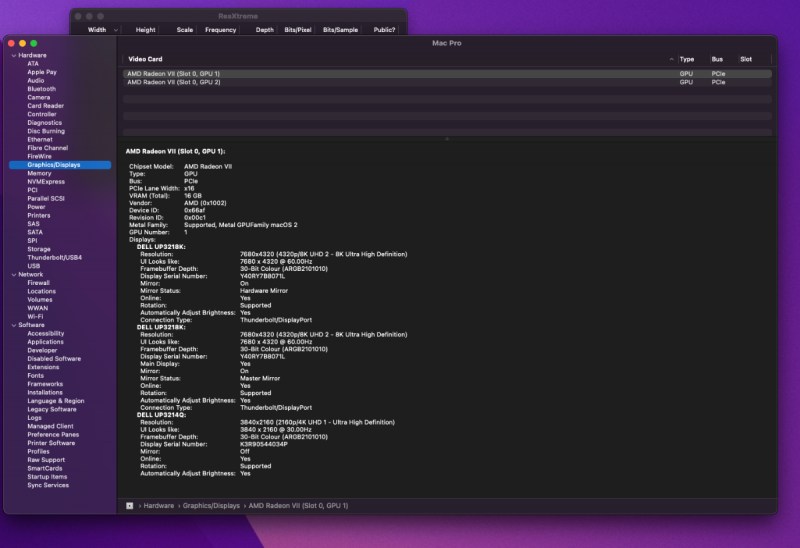

Interestingly, Monterey is the first OSX to fully support Adaptive Sync. Display is much better on this 8K monitor

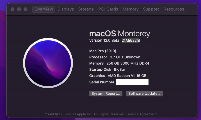

I211 is now working with the old SmallTree kext file on Monterey ß7.  (The same file works with Catalina-BigSur-Monterey.)
The entire time is was a macOS problem, not a SmallTree kext problem. And most likely, the I210 ports will be working again too.
