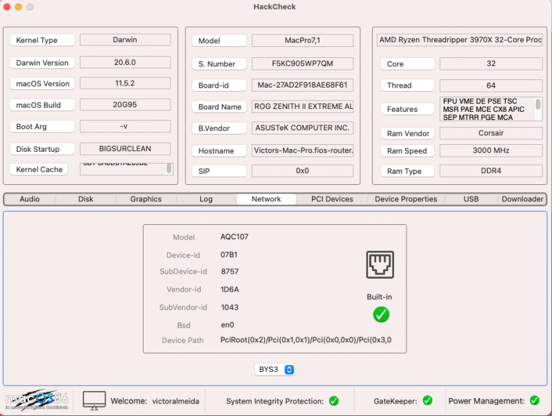

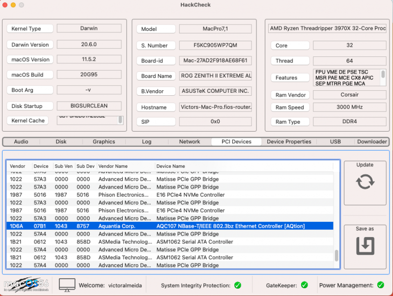

My Aquatina is working  fine on Big Sur 11.5.2 but I can not get it to work on Monterey beta 5.
On 8/26/2021 at 2:15 AM, fabiosun said:
@valmeida
aquatina?
Are you using renaming or device properties?
could you post a screen shot like this?
1150783354_Screenshot2021-08-26at08_15_02.thumb.png.0b17c2197c684be6389ddd4f1162d4a2.png
you can achieve it with HackCheck app or similar application
Here you go . I renamed it.
Edited by valmeida
On 8/28/2021 at 8:42 AM, fabiosun said:
@valmeidaweird
it differs in subvendor and sub device id
but it is weird it works in Big Sur and it doesn't in Monterey
By the way you have DDR4 @3200 in signature but Hack check detect them @3000
The sub-vendor and sub-device IDs are based on the mobo's manufacturer. Therefore, our MSI values will be different from those of ASUS. But no matter, as these ID values will not affect the Kernel patches since they are directly applied to Apple's Aquantia kext file without reference to any ID values.
And even with the patches applied, I've added cosmetic changes (that is, not essential) via SSDT or DevProp changes, and the Kernel patches still work in Big Sur and Monterey. (I've already cautioned @valmeida to use no DevProp during the test phase.) If an SSDT is used, the attachment point at device BYS3 could be changed but that should not be important at this point.
When I look at @valmeida's IORE, which I believe is from a Big Sur boot, we see the following at BYS3. This looks good. And after a boot into Monterey, it should look exactly the same. Please verify.
It is not clear to me why @valmeida's Aquantia patch is working on the ASUS mobo in Big Sur, but not working in Monterey. The fact that the port is seen in HackCheck would suggest that the patch is being injected.
However, to verify this change, turn off the Aquantia Kernel patch for Monterey in the OC config file. After re-booting, the Aquantia port should not longer be visible in HackCheck.
To summarize, @valmeida do two things I've written above. Both will be answered in 2 boots (one with the Monterey Aquantia port enabled and one boot with this same patch disabled):
1. look at the BYS3 section in IORE after a Monterey boot with and without the Monterey Aquantia patch being enabled.
2. look at HackCheck's Network section, again after a Monterey boot with and without the Monterey Aquantia patch being enabled.

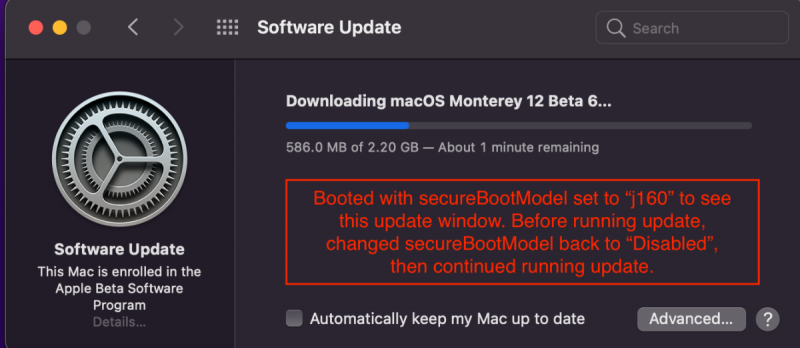

if you do not see this update put j160 in SecureBootModel in your config if you use MacPro7.1 SMBIOS
some problem to update in my case yet
536834832_Schermata2021-08-31alle11_37_46.png.b27938ff6067f9742271a980bf9cd4bf.png.880ebe8fa61abbffd85670aaf6a41d72.png
Edited by fabiosun
solved
To update to Beta 6 (if you do not see it in update)
If you have MacPro7.1 Smbios, and default or Disabled in Misc/security/SecureBootModel
put in Misc/security/SecureBootModel j160 value
reboot
You will find an update message on software update
download it..DO NOT REBOOT
before reboot change secureBootModel in Disabled
then reboot
And it should then update as usual
reboot
then reboot
1943175418_Screenshot2021-08-31at13_45_03.thumb.png.ee5066b2ba500d4d7b20bd066e976736.png
Completely agree with your findings: when SecureBootModel set to "Disabled" (the usual setting in my config file), the Mß6 update was not offered. Once this setting was changed to "j160" for my SMBIOS (MacPro7,1), and the computer was re-booted, the Mß6 Update became visible. (SecureBootModel was then re-set to "Disabled" before running the Update so that re-boots during the update would be run under "Disabled" and not "j160".)
The curious thing is that previous Updates in Big Sur and Monterey were not visible unless SecureBootModel was set to "Disabled" (and csr-active-config set to "00000000"; this setting was unchanged for the Mß6 update). In fact, early on when the SecureBootModel quirk was introduced, I had trouble even booting into macOS if SecureBootModel was anything but "Disabled".

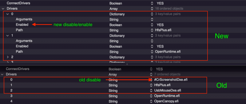

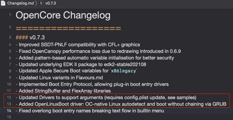

FYI for new updates coming with OC v073. The latest commits change the structure of OC's driver section as shown below.
The OC documentation discusses the changes as seen in the comments inside the ChangeLog file. The changes also include a new driver (OpenLinuxBoot; only needed if booting from OC into Linux):
The changes to the config file are shown next.
These changes sub-divide the string driver list into an array with 3 parts each. One part is to allow arguments for each driver, the 2nd part is to enable or disable the driver (instead of using a "#" symbol to disable), and the 3rd part is for the driver name (with path if not in the expected Drivers folder).
