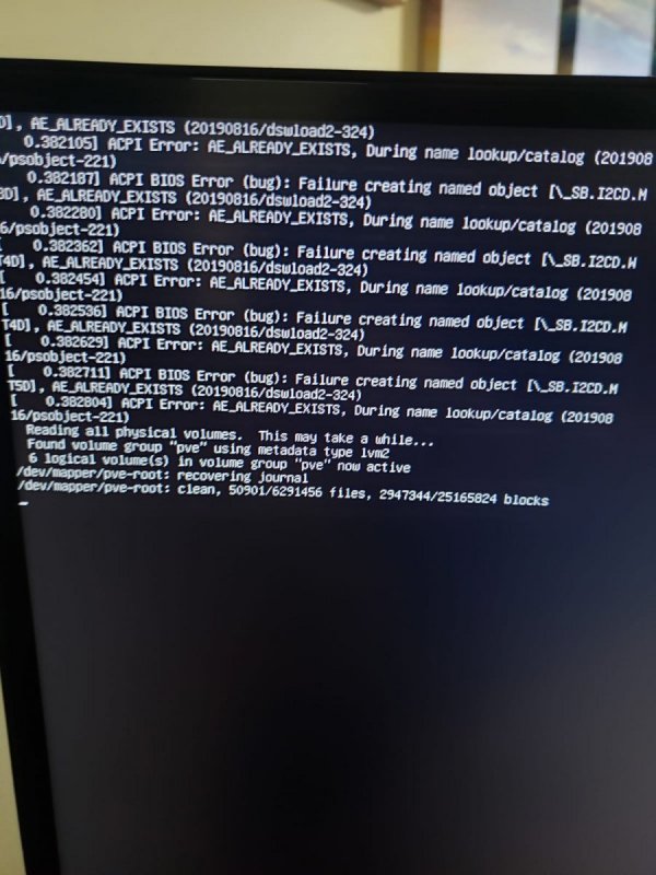

I got my login screen to show again so I'm giving the passthrough another shot.  I'm confused with this part of the guide.
Create a file in etc/modprobe.d/ named vfio.conf:
echo "options vfio-pci ids=10de:1b02,10de:10ef" > /etc/modprobe.d/vfio.conf and add on it:
options vfio-pci ids=10de:1b02,10de:10ef disable_vga=1
My vfio.conf should display both of these lines below?

I changed the address to 05:00 but when adding  pci device, my GPU doesn't show up on the list so I added manually in vm.conf.  Also downloaded the rom for the 5700 and renamed it to 5700xtref.rom but I got the spinner icon when starting my vm.
5700rom.PNG.676af9d6a0deabf57228890e233a8ccd.PNGspinner.thumb.PNG.419973bc67807e8ec4489f982ec39373.PNG
Edited by dtek

The rom file is in /usr/share/kvm.  How do I change display to none?  My vm.conf looks like this

14 minutes ago, fabiosun said:
I am on my mobile but you have many not correct parameter in your vm
1)boot arg
2) number of cores 64 it is fine for 3970x
3)if you have 128gb you have to use less ram in vm config
The other 32 cores are reserved for windows.  I updated my profile to 256gb ram but I don't know why it doesn't show.  This was my original boot arg but I copied @meina222 boot arg since he said the new one has better performance.  Should I revert boot arg back to the original one?  updated vga: none with the same result
 -device isa-applesmc,osk="ourhardworkbythesewordsguardedpleasedontsteal(c)AppleComputerInc" -smbios type=2 -device usb-kbd,bus=ehci.0,port=2 -cpu Penryn,kvm=on,vendor=GenuineIntel,+kvm_pv_unhalt,+kvm_pv_eoi,+hypervisor,+invtsc,+pcid,+ssse3,+sse4.2,+popcnt,+avx,+avx2,+aes,+fma,+fma4,+bmi1,+bmi2,+xsave,+xsaveopt,check
Edited by dtek
Tomorrow I will upload my config
however if you use passthrough of a single gpu you can assign all the resource of your system to a vm
you can’t run 2 vm in this case in the same time
i think problem is on Linux part
also you can use host as cpu and a minimal boot args in vm
it also depends to kernel patches you use in your efi config.plist
if I do not misunderstood you said system works if you do not passthrough gpu?
isn’t it?

Ok looking forward to your config.  I kinda need 2 vms running at the same time so that will not work for me.  The system works 100% without gpu passthrough.  Also there's one part in the guide that I skipped since I don't know how to change "RadeonDeinit" setting in opencore.  My GPU is currently in slot 2,  I'll try to move it to slot 1 and see if that makes a difference.
32 minutes ago, fabiosun said:
Hi @dtek,
As @fabiosun mentioned, I am an active Proxmox user and am typing this from my Proxmox VM, so I hope this helps. I suppose you're trying to run a single GPU as I see you try to shadow the vbios. Here's one of my MacOS VM configs where I pass my 5700XT
args: -device isa-applesmc,osk="ourhardworkbythesewordsguardedpleasedontsteal(c)AppleComputerInc" -smbios type=2 -device usb-kbd,bus=ehci.0,port=2 -cpu host,+invtsc,vendor=GenuineIntel

As you probably know, you need to make sure your vbios is matching your card, and is located in  /usr/share/kvm/ (in my case it is called /usr/share/kvm/vbios.bin).
Also, in the vmhook.sh I run (located in /var/lib/vz/snippets/ ) you need to unbind the framebuffer. I do some other stuff as well (can elaborate), but here's the full hook with highlighted relevant section. Note that I also reboot my host if I shutdown the machine - this is sadly needed due to the reset bug and hopefully will be resolved with the new AMD 6000 cards so I can disable this section - otherwise your GPU will not come back most of the time and you'd be left with a blank screen - hence I comment out re-enabling the framebuffer.

I got this error
TERM environment variable not set.
Starting VM 101 - please wait...
/var/lib/vz/snippets/vmhook.sh: line 15: echo: write error: No such device
TASK ERROR: hookscript error for 101 on pre-start: command '/var/lib/vz/snippets/vmhook.sh 101 pre-start' failed: exit code 1
