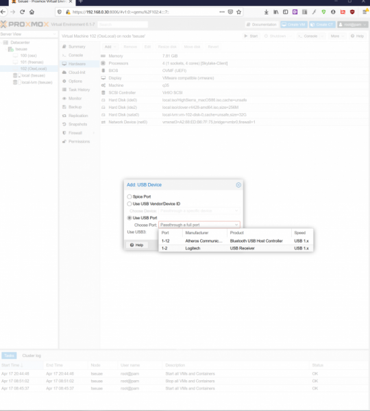

Hi,
 not sure what you mean by " pass your mouse as a single USB port", I can chose the USB receiver, but I do not have a choice to add just one port, there is a single option and that includes port 1-2. below you will see the result of the lspci -nn. BTW is there a way for me to upload a picture?

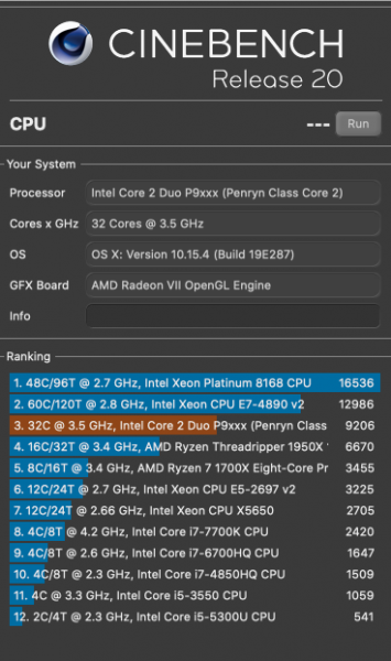

Current cpu features passed through
args: -device isa-applesmc,osk="ourhardworkbythesewordsguardedpleasedontsteal(c)AppleComputerInc" -smbios type=2 -cpu Penryn,kvm=on,vendor=GenuineIntel,+kvm_pv_unhalt,+kvm_pv_eoi,+invtsc,vmware-cpuid-freq=on,+fpu,+vme,+de,+pse,+tsc,+msr,+pae,+mce,+cx8,+apic,+sep,+mtrr,+pge,+mca,+cmov,+pat,+pse36,+clflush,+mmx,+fxsr,+sse,+sse2,+ht,+syscall,+nx,+mmxext,+fxsr_opt,+pdpe1gb,+rdtscp,+lm,+pni,+pclmulqdq,+monitor,+ssse3,+fma,+cx16,+sse4_1,+sse4_2,+movbe,+popcnt,+aes,+xsave,+avx,+f16c,+rdrand,+lahf_lm,+cmp_legacy,+extapic,+abm,+sse4a,+misalignsse,+3dnowprefetch,+osvw,+ibs,+skinit,+wdt,+tce,+topoext,+perfctr_core,+perfctr_nb,+ssbd,+ibpb,+stibp,+fsgsbase,+bmi1,+avx2,+smep,+bmi2,+rdseed,+adx,+smap,+clflushopt,+clwb,+xsaveopt,+xsavec,+xgetbv1,+xsaves,+wbnoinvd,+arat,+npt,+lbrv,+nrip_save,+tsc_scale,+vmcb_clean,+flushbyasid,+decodeassists,+pfthreshold,+umip
Current cpu features seen by macOS:
machdep.cpu.features: FPU VME DE PSE TSC MSR PAE MCE CX8 APIC SEP MTRR PGE MCA CMOV PAT PSE36 CLFSH MMX FXSR SSE SSE2 HTT SSE3 PCLMULQDQ SSSE3 FMA CX16 SSE4.1 SSE4.2 x2APIC MOVBE POPCNT AES VMM XSAVE AVX1.0 RDRAND F16C
machdep.cpu.leaf7_features: RDWRFSGS BMI1 AVX2 SMEP BMI2 RDSEED ADX SMAP CLFSOPT CLWB UMIP STIBP SSBD
machdep.cpu.extfeatures: SYSCALL XD 1GBPAGE EM64T LAHF LZCNT PREFETCHW RDTSCP TSCI
Edited by Pavo
@Pavo cpu is fine, you can see comparing in real way with no vm benchmark using traditional patches
gpu benchmarks are missing for now
have you some problem there?

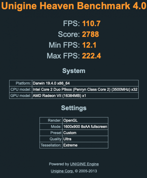

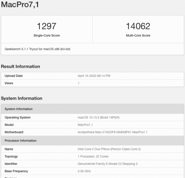

@Renato
for inserting pictures you can drag and drop when you are writing your message

@Pavowhen you have time also cinebench 15 gpu bench
uf you have also  windows one and real hack with patches
to see if important differences are there
by the way you can also try to put host in vm cpu and use amd vanilla patches to boot.
10 hours ago, Renato said:
Hi,
00:14.0 USB controller [0c03]: Intel Corporation Sunrise Point-H USB 3.0 xHCI Controller [8086:a12f] (rev 31)
have you passed this one?
if you do not pass it, in Web interface/hardware/usb part what do you see?
I don't have winblows installed and don't have the bare metal install EFI for Opencore anymore, all I can tell you is its WAY better in this configuration.

I see @Renato i think in this way is fine
so if you cant see a mouse attached to it the only way for now is to connect your mouse on a onboard usb port
I cant see your hardware in your signature but i think some spare usb port could be there on your motherboard
