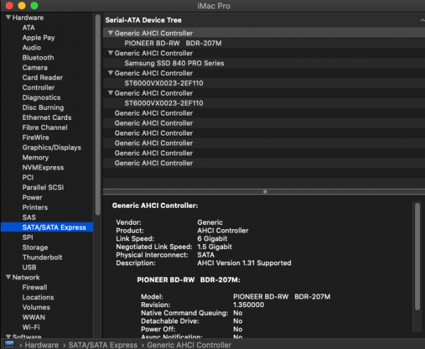

These are some of passed drive (passed 2 sata controllers)
and following Asmedia and USB 3.1 and 3.2 USB controllers passed completely :

In initial stage of my experience in proxmox I have not tried to pass an entire controller as I did now so it could work also as you say. Not tested
Instead I tested well a thing passing and using an SSD with Catalina installed on..and it is working with EFI installed on it (same of HS or Mojave in my case)
There is a "bug" I think in OVMF bios
Inside it I have all my disk connected in sata controller passed but it is not possible to save a correct boot orders if you delete "qemu filled drive".. I think is a bug but if no other user can confirm it should be also a problem of my little knowledge ! 😉

to have a mainteined boot order with no qemu disks I have now:
1173972741_ScreenShot2020-04-15at7_06_03AM.thumb.png.3bf7a050df7f6ba161399380a7d093b4.png
I mean to see here my ssd booting drive, now it is not present and OVMF firmware seems to not maintain booting order I choose:
If you have some idea/advice it is welcomed 🙂
I am trying by now to pass it as single disk..we will see

You must have the EFI drive attached to the VM and add the OpenCore.efi as a boot option as the first selection in the boot order in the Proxmox VM BIOs., I'll upload some pictures with steps later today.
thank you for uploading pictures..but you have also to delete all your qemu drive (if you have in VM conf) and see if after a cold boot your boot sequence is fine, in my case it starts always with network
entering in bios and select sata passed disk it boots fine
