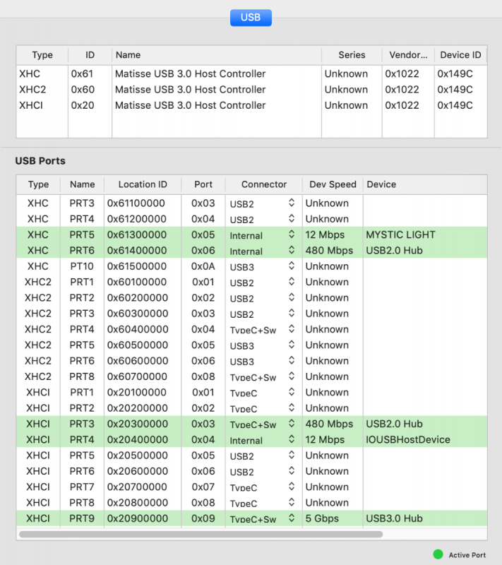

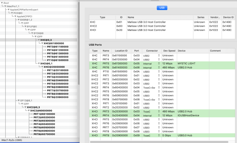

Support Team iCanaro Posted February 16, 2021 Author Support Team Share Posted February 16, 2021 Esperimento per mappatura e definizione connettori tramite solo ssdt.... lavori ancora in corso: 1 Link to comment Share on other sites More sharing options...
tuxy Posted February 16, 2021 Share Posted February 16, 2021 8 hours ago, iCanaro said: Esperimento per mappatura e definizione connettori tramite solo ssdt.... lavori ancora in corso: Qui andiamo sul difficile , per le USB?? Link to comment Share on other sites More sharing options...
Support Team iCanaro Posted February 16, 2021 Author Support Team Share Posted February 16, 2021 @tuxy beh dallo screenshot mi pare evidente; siccome per me hack è come da ragazzini che un giorno si e uno no si smontava il carburatore del motorino, marmitta e motore, in hack il semplice fatto che vada e vada anche bene, non lascia fermo e maneggio sempre qualcosa, che magari non capisco bene, ma comunque mi diverte. In questo caso ho usato un diverso ssdt per la mappatura e l'ho personalizzato per la unify con tanto di secondo type c Link to comment Share on other sites More sharing options...
Support Team iCanaro Posted February 17, 2021 Author Support Team Share Posted February 17, 2021 considerando la conformazione del pannello posteriore letto un po' di cose sulle USB https://www.cuidevices.com/blog/usb-type-c-and-3-1-gen-2-clarified https://www.st.com/content/ccc/resource/sales_and_marketing/presentation/product_presentation/group0/5a/b1/8e/6c/2b/0d/46/3c/Apec/files/APEC_2016_USB_Power.pdf/_jcr_content/translations/en.APEC_2016_USB_Power.pdf https://www.st.com/resource/en/application_note/dm00536349-usb-typec-power-delivery-using-stm32-mcus-and-mpus-stmicroelectronics.pdf https://www.kernel.org/doc/html/latest/driver-api/usb/typec.html visionato quanto esposto da gengik https://www.macos86.it/files/file/71-patch-usb-connector-type/ /* * Maintained by Gengik84, MacOS86.it * * example: * Return (GENG (One, 0x03)) for connector type usb3 ( standard connector ) * or Return (GENG (One, 0x09)) for connector type usb3 type C ( HS+SS with Switch ) * or Return (GENG (One, 0xFF)) for internal (255) * * Other connector type available: * * Return (GENG (One, 0x00)) for connector type usb2 ( Type A ) * Return (GENG (One, 0x0A)) for connector type usb3 type C ( HS+SS without Switch ) */ quindi se ho capito bene, le USB 8 e 10 sono 0x0A, la 9 ovale type c 0x09 quella sopra 0x0A, la 7 0x00, quelle del case e interne mobo 0xFF non ancora completamente definito, ma a buon punto PS: ricordo che è definito e mappato tramite ssdt e non si usa nessun usbports.kext 1 Link to comment Share on other sites More sharing options...

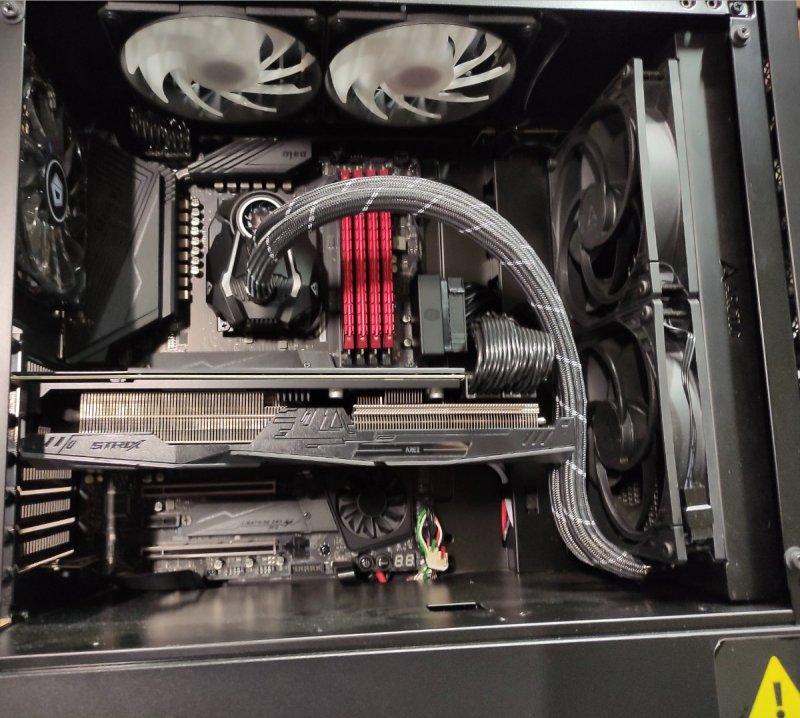

Support Team iCanaro Posted March 8, 2021 Author Support Team Share Posted March 8, 2021 arrivato come previsto da amawar l'Artic Liquid Freezer II 280 diciamo che quelli di amaz sono stati un po' birichini, questo AIO è il reso di un furbacchione che l'ha usato un po' e poi l'ha restituito, per cui aveva una certa quantità di polvere e la ventolina a volte emetteva un certo ronzio. Smontato tutto, ripulito a modo con aria compressa e lubrificato con una goccia di olio di vaselina la ventola, poi lasciato girare per qualche ora sul banco, perfetto tutto rientrato nella normalità. In Caso qualcuno si domandi del perché è stato montato con in basso l'ingresso dei tubi sul radiatore, facciamo un po' di divulgazione 😛 Gamers Nexus Spoiler Prophecy Tech by Nexthardware Spoiler 1 Link to comment Share on other sites More sharing options...

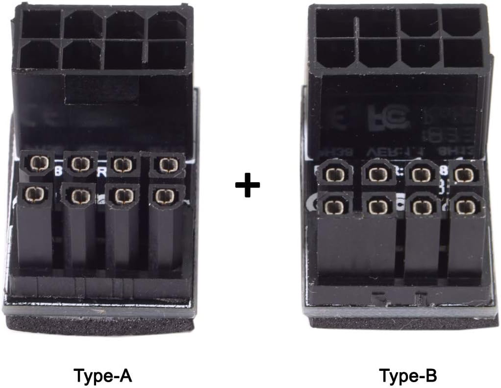

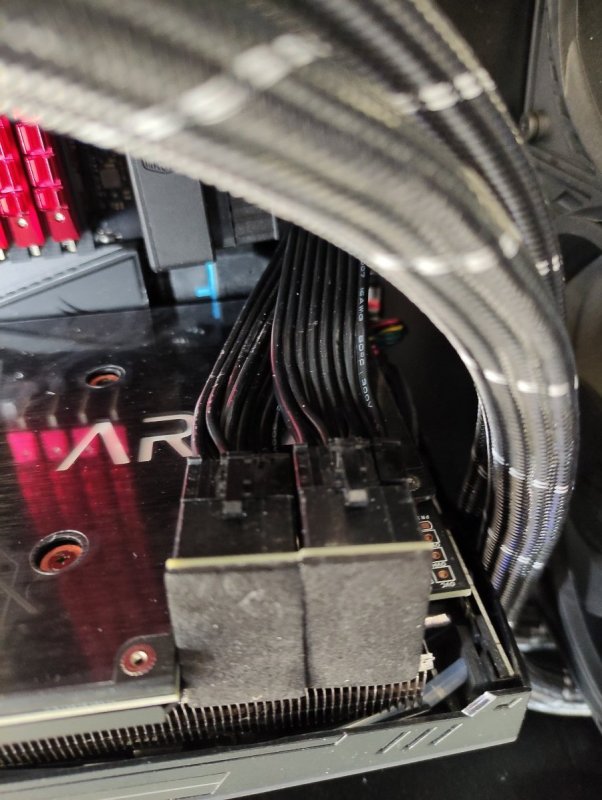

Support Team iCanaro Posted March 12, 2021 Author Support Team Share Posted March 12, 2021 Montato: Adattatore ATX a 180 gradi da connettore a 8 poli femmina a connettore a 8 poli maschio, adattatore di alimentazione angolato per scheda grafica per computer desktop https://www.amazon.it/gp/product/B07P3JDQNC/ Per me molto più ordinato e pulito 👍 1 Link to comment Share on other sites More sharing options...
